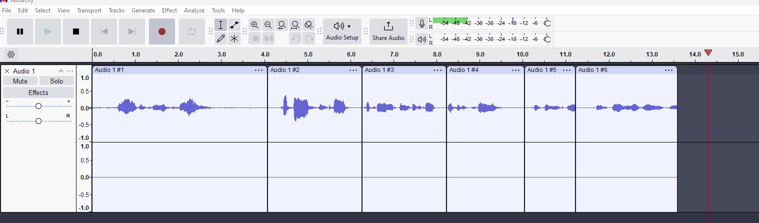

I can get input to audacity and play it back through my laptops speakers, however, the quick start guide does mention that you should actually get 2 tracks recorded back. An unedited track and then a track with noise cancellation. This is not happening.

all recordings I have taken can be played back through my laptop speakers at 16-bit, 48kHz. Witch is the same as the bit and sample rate as the "STM MIC + SPEAKERS" driver. This makes me less inclined to blame the windows settings for the current issue.

Result
At this time I have output to speakers, through the CCA01M1 board (Powered by 5V from CN6.5 to CN2.VCC)(Note this is shown in UM1979, section 3.2.2)
And in Audacity I have the Left channel recording only.
This is where the Quick Start Guide Version 1.0 Jan, 2021 and the UM2824 Rev 2 both state along the lines of:
" . The stereo track contains the processed signal in which the acoustic echo cancellation has removed the far-end signal from the audio acquired by a microphone and an omnidirectional microphone as a reference"
But I have only ever got the Left channel, which the readme located here: en.fp-aud-aec1-1.1.0\STM32CubeFunctionPack_AEC1_v1.1.0\Projects\STM32F446RE-Nucleo\Demonstrations\AEC
States:
"The stereo track contains the processed signal (L channel) and an omnidirectional microphone
as a reference (R channel)"
