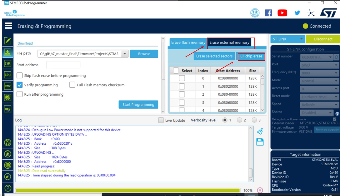

you can use STM32CubeProgrammer , it is an excellent tool for programming and erasing internal & external flash memory. Here’s how you can use it to perform a mass erase and format the external flash:
  1. Download and Install STM32CubeProgrammer:
  2. Connect Your Microcontroller:
    • Connect your STM32 microcontroller to your PC using a USB cable or ST-LINK programmer.
  3. Open STM32CubeProgrammer:
    • Launch the STM32CubeProgrammer application.
  4. Select the Target:
    • In the "ST-LINK Configuration" tab, select the appropriate interface (e.g., ST-LINK, USB, UART) and connect to your target microcontroller.
  5. Mass Erase:
    • in the "Erasing & Programming" tab Select the "Full chip erase" option to perform a mass erase of the flash memory
