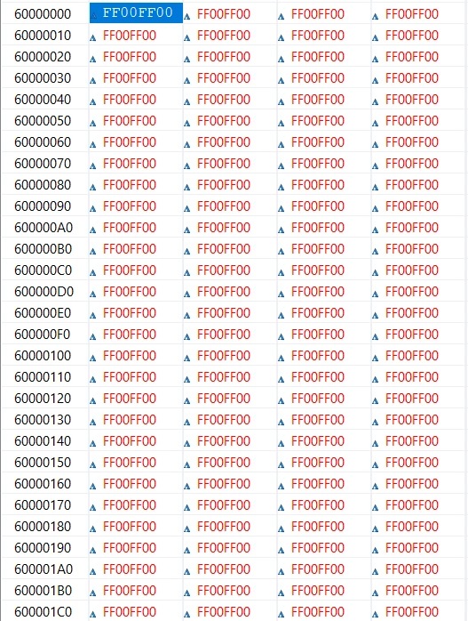

I am trying to use FMC on an STM32U5G9J-DK2 to communicate with an LCD (ST7789). I am trying to send initialization commands to the device as follows
define FMC_BANK1_REG ((volatile uint16_t *)0x60000000)
#define FMC_BANK1_DATA ((volatile uint16_t *)0x60000002)
void write_command(uint8_t data)
 volatile uint16_t *p = FMC_BANK1_REG;
 *p = (uint16_t)(data);
void write_data(uint16_t data)
 volatile uint16_t *p = FMC_BANK1_DATA;
 *p = data;
// Ex:
write_command(0xFF)
However, when I write 0xFF to memory at address 0x60000000, I don't just see the value written to the single memory address. Instead, it appears to be writing to many subsequent memory addresses. What I see is FF00FF00 written to all addresses between 0x60000000 and 0x600001CC. I understand that the memory is little endian, so FF00 is expected. However, I am unsure why it is repeating to other addresses. I am using the default, CubeMX generated code for FMC initialization, shown below.

If anyone could provide help on this matter, it would be greatly appreciated.

What's the screen shot showing? A memory view of FMC.
You're probably decoding one address bit, so read content is just going to repeat, as that bit goes high and low whilst other undecoded bits go ignored.
