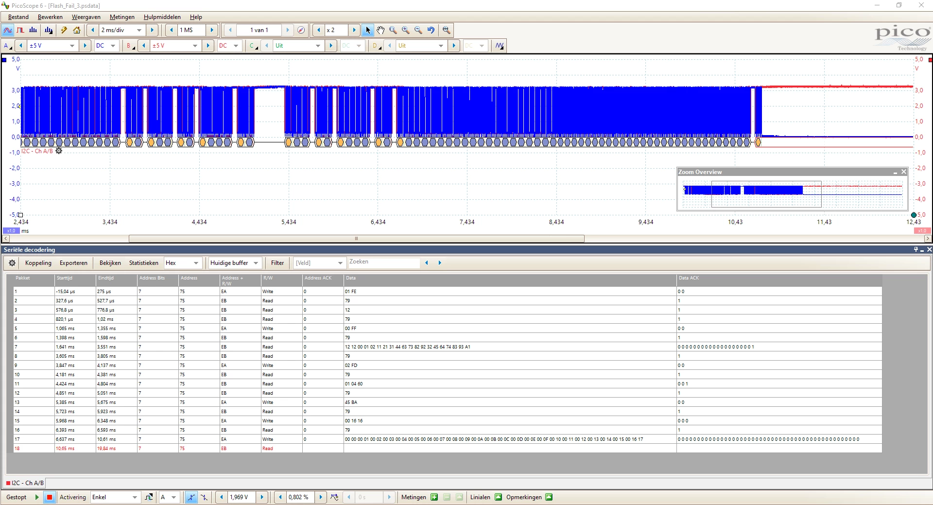

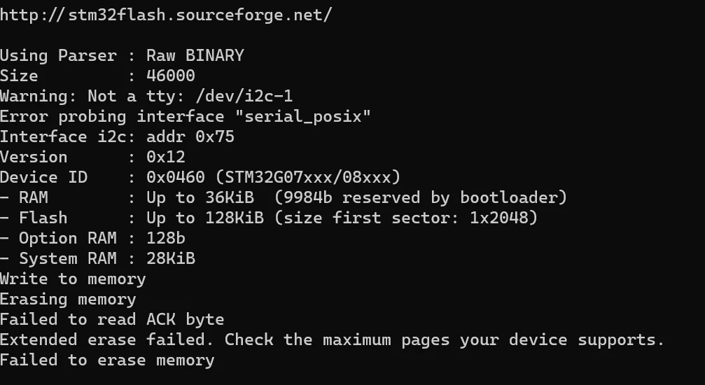

Flashing over I2C. Worked a couple of times now its not acknowledging.
I'm trying to flash my STM32G071 over I2C1 on adress 0x75 @ 100kHz. Communication is working but when it tries to Erase it fails.

Have you tried erasing using other tool, such as STM32CubeProgrammer?
CPrui.1
CPrui.1Author
Dec 10, 2021 9:02 AM UTC
Yes, STM32CubeProgrammer doesnt support programming over I2C. Only ST-Link (JTAG, SWD), UART and USB
