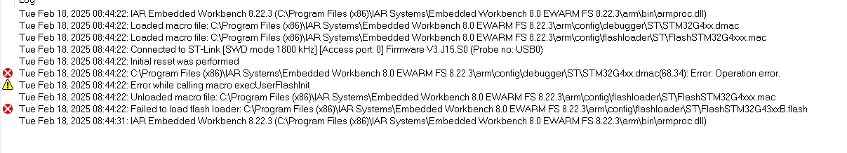

When trying to Download and Debug, the following error appeared in the IAR Debug Log:

Questions
  1. Does IAR 8.22.3 fully support flashing STM32G431RB after applying the patch, or is a newer IAR version required?
  2. Are there any updated STM32G4 flash loaders (.flash files) from ST that work for STM32G431RB?
  3. Is there a way to manually modify an existing flash loader for STM32G431RB?
  4. Why is STM32CubeProgrammer missing an external loader for STM32G431RB?
  5. Has anyone successfully flashed STM32G431RB in IAR 8.22.3? If so, how?
Any insights or suggestions would be greatly appreciated. Thanks!

Hello @Umesh_Kumar278
Please find attached the old EWARM patch supporting STM32G431RB part numbers.
Note: There is no need to install this patch with the new EWARM version starting from V8.50, as it is already taken into consideration by the toolchain itself.

Hello @KORKAD ,
I tried the latest patch and modifying the .mac file. I managed to do that , and I will try with this patch as well.
Thanks and regards,
