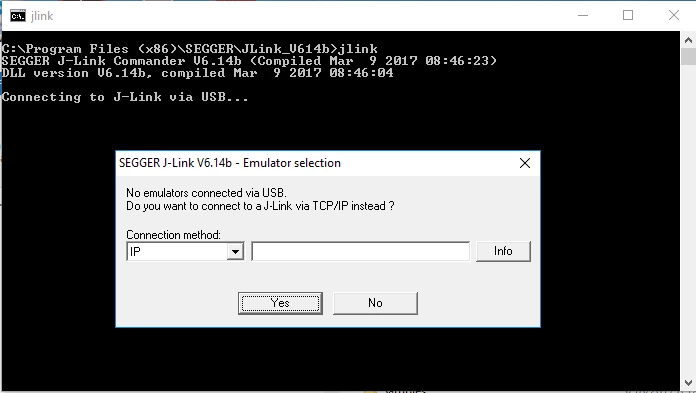

I recently discovered that after using VisualGDB to connect to my STM32 - that none of the Segger utilities worked any more.  Just a message: ''No emulators connected via USB'' (despite other software seeing the J-Link)
Upon testing OpenOCD in Visual Studio w/VisualGDB, this message will pop up, wanting to change the USB drivers:
Once changed, none of the Segger J-Link utilities will work any more (not a surprise). Making it work again? Not so easy.
I've posted some information on my experience and detailed instructions on how I fixed it:
http://gojimmypi.blogspot.com/2017/03/Segger-J-Link-STM32-with-VisualGDB.html
In short: delete Segger USB and software from control panel, re-install fresh, then manually update USB drivers with the code in your install directory, in my case:
C:\PROGRAM FILES (X86)\SEGGER\JLINK_V614B\USBDRIVER\
I am cross posting this to both the st.com and sysprogs.com forums in the hopes that both companies will contact each other and come up with a more graceful solution to switching between tools.
