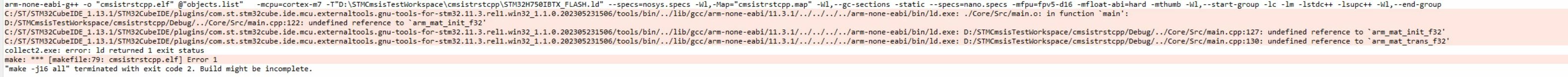

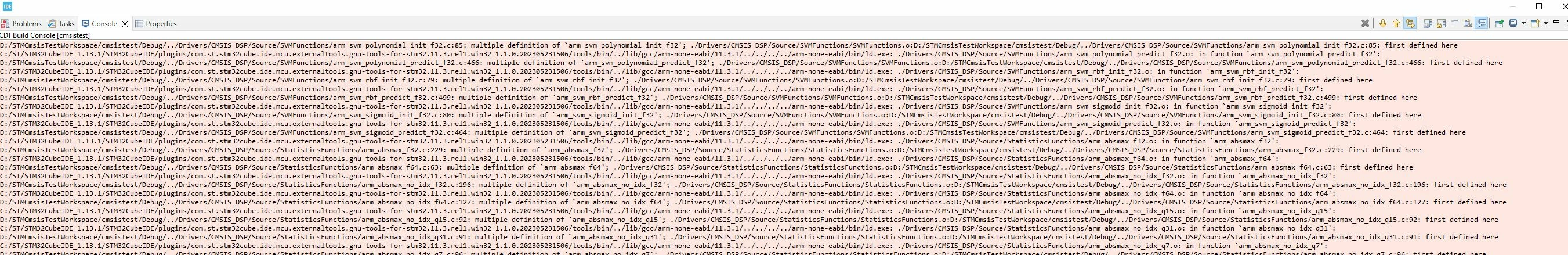

I am trying to use the newest cmsis dsp library (v1.15) to implement a vector matrix implementation. I am running into a "first defined here error" when trying to build with the cmsis dsp library (v1.15). I created an empty project just to try out building a project with the library included. I am running into the same issue there.
I am using STM32CubeIDE version 1.13.1 and an STM32H750 with an M7.

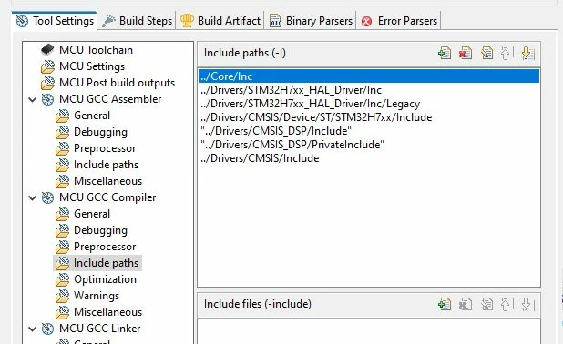

Here you can see the folders I included.
Am I missing something? How can I use the newest CMSIS library? I couldn't find any helpful documentation on the internet.

I found a solution to my problem. As I stated in my original question, it is necessary to include the CMSIS Source folder in the project, so the newest CMSIS version can be compiled.

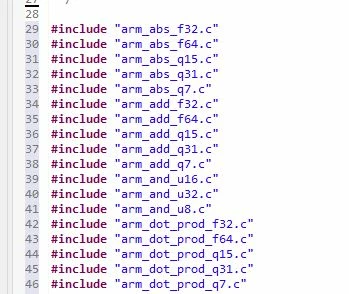

Doing so results in a multiple definition error. The reason for this is, that the subfolders of "Source" have a ".c" file beginning with a capital letter (in the "BasicMathFunctions" folder it is "BasicMathFunctions.c" and BasicMathFunctionsF16.c").
These files include ".c" files causing the multiple definition error on my system.
Excluding these ".c" files from my build fixed my issue. Solved: Re: Error including the CMSIS include files in the... - STMicroelectronics Community describes a similar problem to mine.

The DSP folder must contain the include folders. Then add a new path in order to support header file as already described in Configuring DSP libraries on STM32CubeIDE - STMicroelectronics Community section 2. Including the DSP libraries and header files.
For that please remove "Source folder" in your project.
Please let me know if the issue is solved!

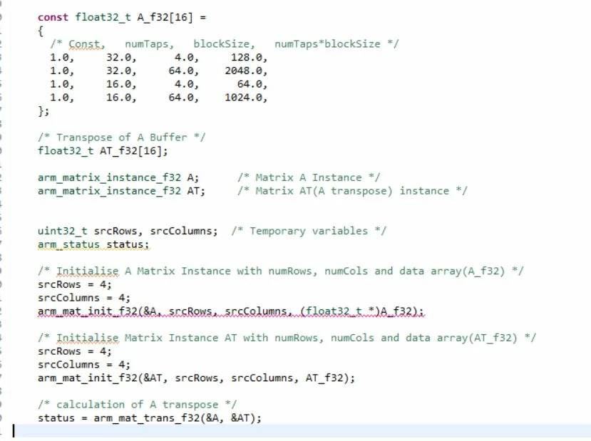

When I remove the "Source" folder, the project compiles without errors. As soon as I am using functions included in the arm_math.h I get an "undefined reference" error.
Here is the code in my main function.
A new path ist added to support the header files (as shown in my original post).

Building the project works and using functions such as "arm_mat_trans_f32" work when using the headerfiles of the newest CMSIS version.
I tried to implement the vector matrix multiplication, that I intended to use the updated library for, as these functions are not included in older versions of CMSIS. When compiling I get a "undefined reference to 'arm_mat_vec_mult_f32' " error.
