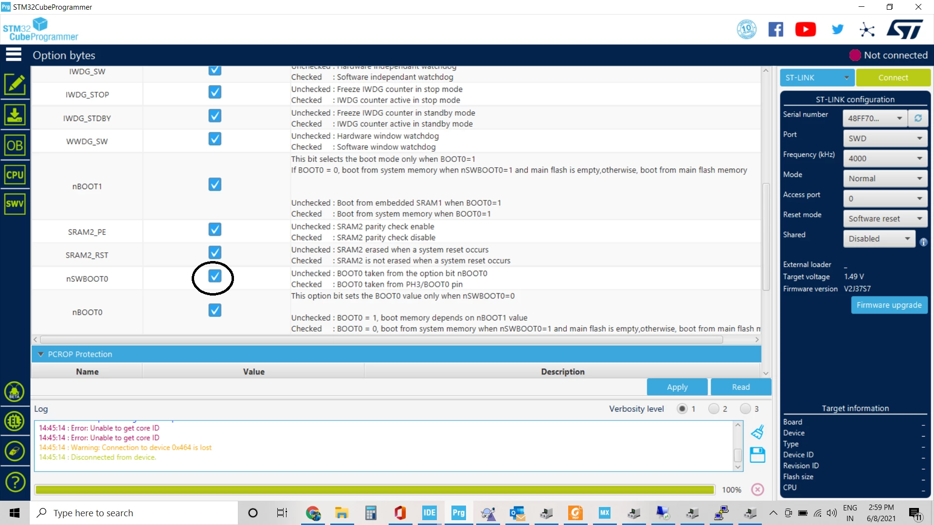

FIrmware faulty jumps into DFU mode while plugging into my PC.
STM32L422kb
I have created a USB sensor project through MX cube as FreeRtos based CDC device in FS mode. The sensor is detected as a com port in the device manager while I connect to the USB port in my PC. But sometimes it won't, It detected as a DFU(STM32 Bootloader) device under the USB section. It means the firmware jumps into the bootloader during powerup.
How to lock up the bootloader jumps? Is there anything I am missing in the configuration?
Boot0 pin is idle. (No external pull-up or Pulldown).
Please configure nSWBOOT0 and nBOOT0/nBOOT1 option bytes with the STM32CubeProgrammer, these options should be available on L422.
Param sivan
Jun 8, 2021 9:55 AM UTC
0693W00000BaNlpQAF.pngThanks for the replay.
Currently, all checkboxes are activated.
Shall I uncheck "nSWBoot0" to directly jump to the main flash memeory?
How to add these settings to the firmware?

>> Shall I uncheck "nSWBoot0" to directly jump to the main flash memory?
As you don't have external Pull-Down on BOOT0, you have to use the option byte. So I recommend to uncheck it.
You can either use the -ob option when programming your boards at production time:
STM32_Programmer_CLI.exe -c port=SWD -d "your firmware" -ob nSWBOOT0=0 nBOOT0=1
Or you can program it from the firmware itself using the FLASH HAL functions, and jump to your code after flashing.

Thanks to @Mike_ST​ . It solved my issue :)
I am using the HAL flash function and fixed the bug.
