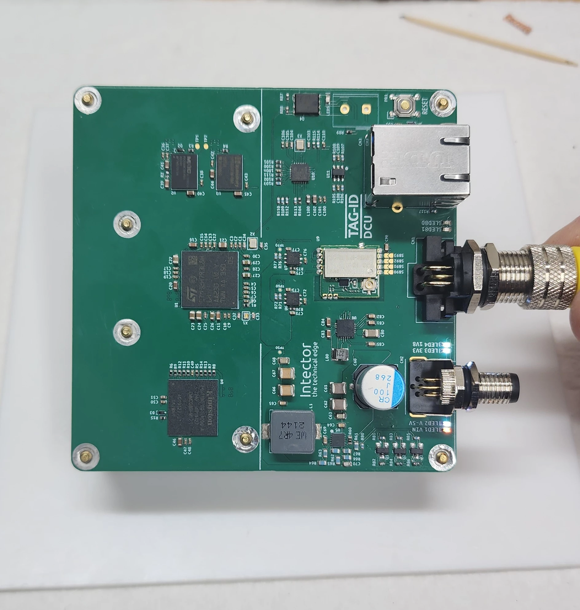

Hello everyone,
I'm working on a project for which I designed a custom board. It consists of the following components.
  • STM32H7R3L8H6H MCU
    • Arm® Cortex®-M7 32-bit 600 MHz MCU, 64 KB flash, 620 KB RAM, Ethernet, 2x USB, 2x FD-CAN, advanced graphics, 2x12-bit ADCs
  • MX25UW25645GXDI00-T
    • 1.8V 256M-BIT [x 1/x 8] Read-While-Write Octal SPI Memory
  • APS256XXN-OBR-BG
    • 1.8V 256M-BIT Double-Data-Rate Octal SPI PSRAM with x8/x16 interface
  • EMMC08G-MV28-01J10
    • 8G-BYTE eMMC chip
  • LAN8742A-CZ-TR
    • MII/RMII 10/100 Ethernet Transceiver with HP Auto-MDIX and flexPWR® Technology
  • L6364Q
    • dual channel transceiver IC for SIO and IO-Link sensor applications
  • RC-SPIRIT2-xxx
    • RC-SPIRIT2-915 module based on STMicroelectronics S2-LP transceiver

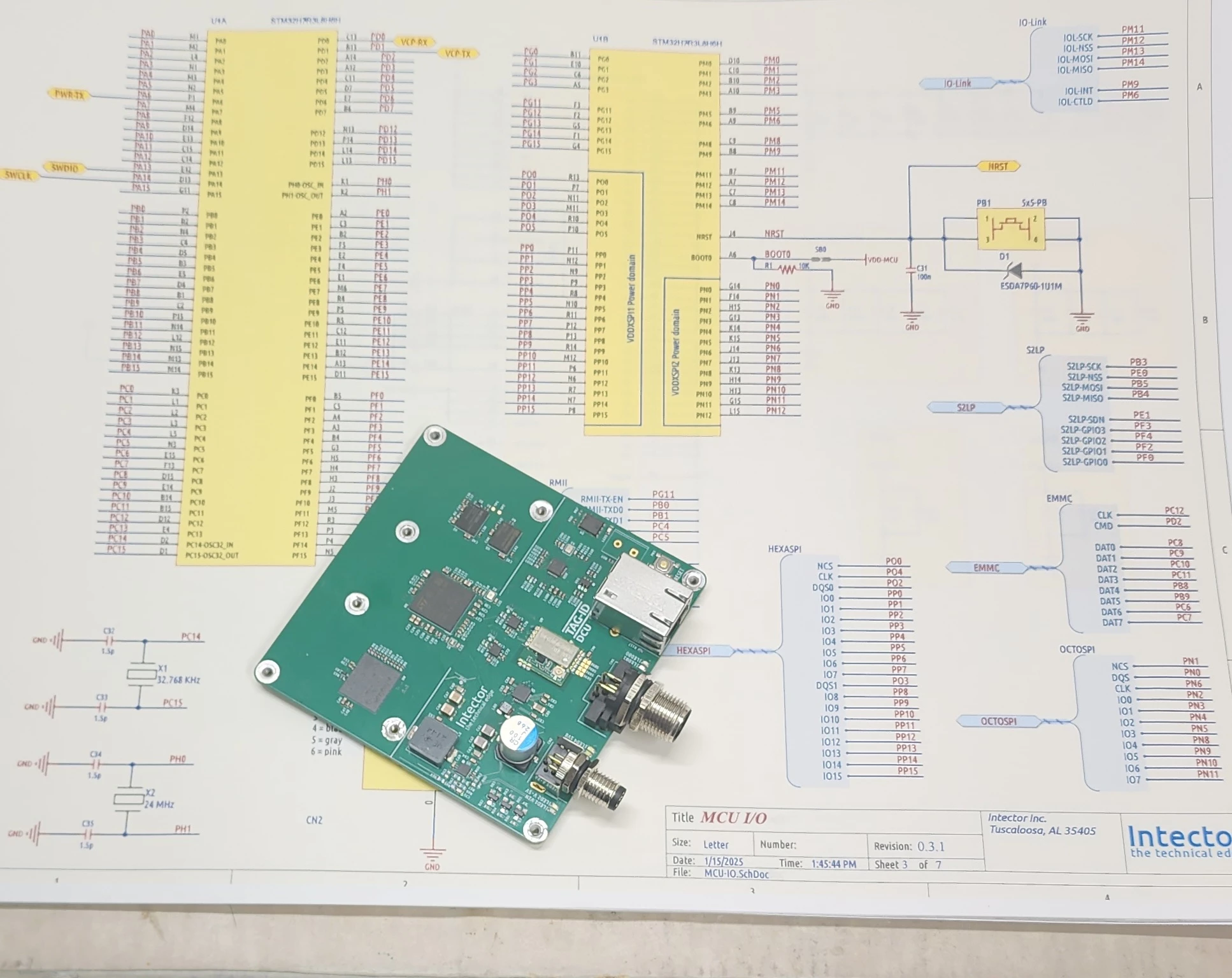

Here are some pictures of the board:
I chose this MBU because it's a potent and flexible device with many possibilities. The downside is that it is relatively new and not commonly used. During my work on this project, I encountered many challenges and obstacles. The investment of countless hours, unmeasurable volumes of coffee, and the help of this forum made it possible to overcome most of them.

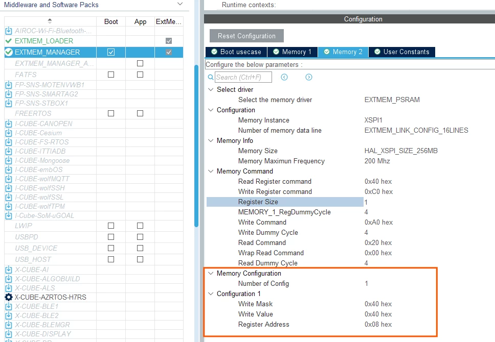

Remember: We used the Memory 2 tab to place our PSRAM chip. At the bottom of this tab, you can select how many configurations you want for your PSRAM chip. I chose one and used it to place the settings for the Memory-Mapped mode.
Here is the loop which is used to write to the registers of the PSRAM chip:

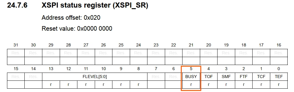

It uses the HAL functions to do the heavy lifting. If we follow the HAL_XSPI_Command function, we will find, besides a bunch of parameter asserts, a function call to wait for a flag to be set.
 /* Wait till busy flag is reset */
 status = XSPI_WaitFlagStateUntilTimeout(hxspi, HAL_XSPI_FLAG_BUSY, RESET, tickstart, Timeout);
In our case, we wait for the BUSY flag in the XSPI_SR register to be RESET with a timeout of 100ms.
Unfortunately, this will never happen, even if we wait forever.

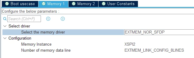

Many of the XSPI configuration parameters for the external Flash are irrelevant because the Memory Manager will use the Serial Flash Discovery Protocol to discover all crucial settings from the chip itself. The SFDP is only used if EXTMEM_NOR_SFDP is selected.

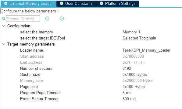

The EXTMEM_LOADER settings must be adjusted according to the used chip. These are the settings for the MX25UW25645GXDI00 chip that I've used:

The Memory Manager parameter MemorySize requires the unit MBit instead of MByte. This is wrong in the firmware examples and could confuse.
