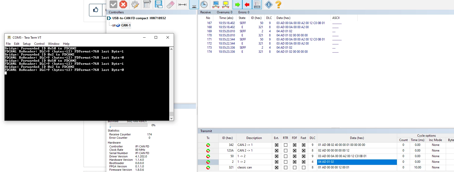

Currently I am trying to send 12 Bytes of Data from IXXAT Terminal over to FDCAN1 which receives the message fine and then Output the Message on FDCAN2 though a buffer. So My logic is when a message pass the filter it gets called by the Fifo0Callback and push it to a buffer below. This works fine the buffer also get the full 12Bytes of data same FD format and everything checked out.
But when I try to add the message to HAL_FDCAN_AddMessageToTxFifoQ(&hfdcan2, &TxHeader2, TxData2). Where TxData is the dequeued message from the buffer and copys the 12Bytes. The message somehow gets truncated to 8Bytes on output.
Heck, when I add "if (HAL_FDCAN_GetTxFifoFreeLevel(&hfdcan2) > 0)", It somehow says it is full even when starting the code.

Sorry.
The issue is on my Tx
I have configured my Tx as follows
TxHeader2.Identifier = 0x321;
TxHeader2.BitRateSwitch = FDCAN_BRS_ON;
TxHeader2.FDFormat = FDCAN_FRAME_FD_BRS;
 TxHeader2.IdType = FDCAN_EXTENDED_ID;
 TxHeader2.TxFrameType = FDCAN_DATA_FRAME;
 TxHeader2.DataLength = FDCAN_DLC_BYTES_12;
 TxHeader2.ErrorStateIndicator = FDCAN_ESI_PASSIVE;
 TxHeader2.TxEventFifoControl = FDCAN_NO_TX_EVENTS;
 TxHeader2.MessageMarker = 0;

Feb 6, 2026 10:34 AM UTC
I will reword my issue
I am defining a 12-byte payload and setting TxHeader.DataLength = FDCAN_DLC_BYTES_12. In debug mode, I can verify that the header value is correctly set to 0x00090000 (DLC 9). However, my IXXAT analyzer shows the message arriving with DLC 8 and only the first 8 bytes of data.
Even when sending internally from FDCAN2 to FDCAN1, the RxData array only updates the first 8 bytes, while the remaining 4 bytes remain zeroed, despite the RxHeader reporting a DLC of 12.
Also another issue I am facing is when I add this. It say FifoFreeLevel is == 0

Feb 6, 2026 10:49 AM UTC
What that printf is showing here for the DLC?: DLC 12?
					printf("FDCAN1 RxHeader: DLC=%lu (bytes=%u) FDFormat=%lu last Byte=%u\r\n",
							TxHeader2.DataLength,
							Can_DlcToBytes(TxHeader2.DataLength),
							TxHeader2.FDFormat,
							TxData2[11]);
And what Can_BytesToDlc() returns here?
TxHeader2.DataLength = Can_BytesToDlc(currentPacketSize);
Try to force TxHeader2.DataLength with:
FDCAN_DLC_BYTES_12
Qin1Author
Feb 6, 2026 10:52 AM UTC
DLC = 9
Bytes = 12
Qin1Author
Feb 6, 2026 10:55 AM UTC
I did that and still the same result

Qin1AuthorBest answer
Feb 6, 2026 12:29 PM UTC
Ok I found the issue....It's ridiculous simple mistake but it solved my issue.
I realised that when configuring TxHeader FDFormat my mistake was:
TxHeader1.FDFormat = FDCAN_FRAME_FD_BRS;
however it should be
TxHeader2.FDFormat = FDCAN_FD_CAN;
But anyways that solved my issue.
