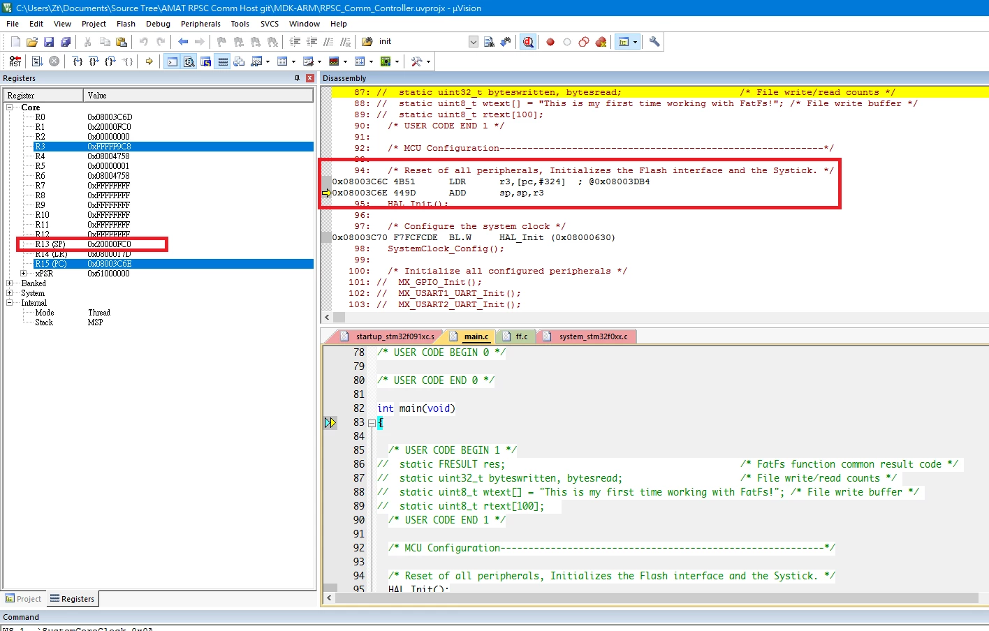

Now I open my IDE and prepare to see how SP Register is going to grow,
Just in the main loop, not beginning doing anything, I got the above bizzare two disassembly
0x08003C6C 4B51 LDR r3,[pc,#324] ; @0x08003DB4
0x08003C6E 449D ADD sp,sp,r3
when these two instruction are executed, and then begin to HAL_Init(), my stack point immediately run to
0x200000988 ->already stack overflow!
I would like to know what is taking these gigantic stack memory, just in the beginning of main loop!!
attached files are my map file and startup file.
I use cube MX and microlib option is enabled in the Keil IDE.
Please help me and thanks for reading this post!

Zt Liu
Zt LiuAuthorBest answer
Senior III
Apr 25, 2017 2:15 AM UTC
Posted on April 25, 2017 at 04:15
Ooooops! I just found that I made some serious mistakes.
I've created some big arrays in the main loop, should make them global!
So, the moral today: Never declare big arrays in the main function!
AvaTar
Senior III
Apr 25, 2017 9:20 AM UTC
Posted on April 25, 2017 at 09:20
The map file would be one of the first places to check in those cases.
There is nothing inherently wrong with declaring such arrays on the stack - if the live time and visibility fits your requirements, AND you make the stack large enough.
