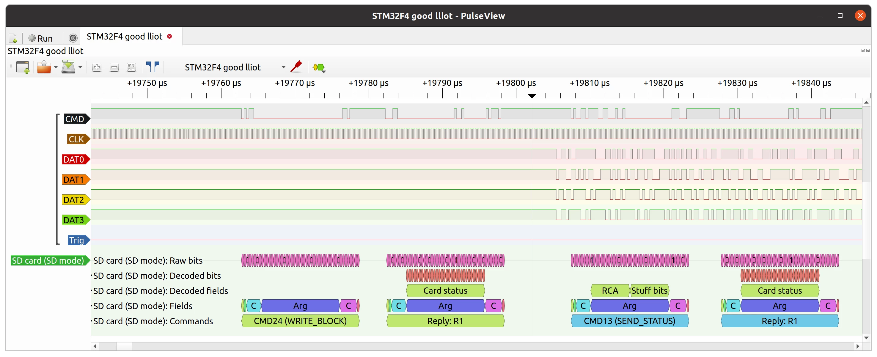

I happen to have a NUCLEO-F413ZH lying around, so I unplugged my SD card adapter from the NUCLEO-L4A6ZG and plugged it into that, then ported my test case. It runs great, reading and writing with DMA! However, I need to use the L4 chip (for the low power consumption). So, I'm still trying to figure out why that gets hung up in HAL_SD_WriteBlocks_DMA .

I'm back on the NUCLEO-L4A6ZG trying to run the same test case that runs successfully on the NUCLEO-F413ZH.
On the NUCLEO-F413ZH, here's what I see with a logic analyzer on the SD bus when I call HAL_SD_WriteBlocks_DMA:

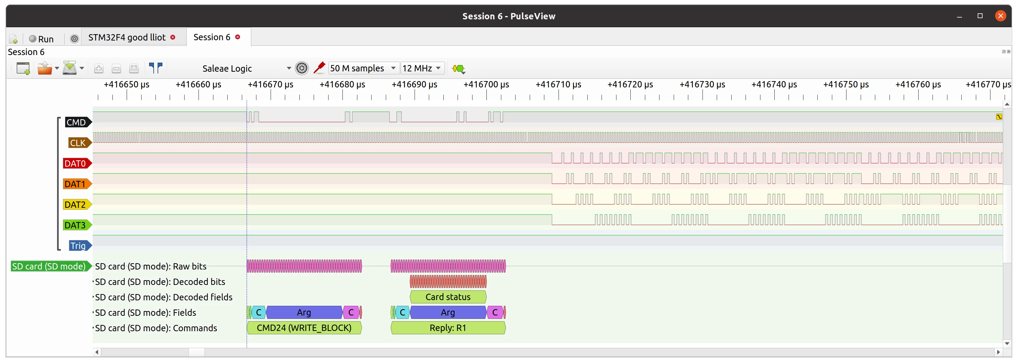

0693W00000LxcmFQAR.pngOn the NUCLEO-L4A6ZG, here's what I see with a logic analyzer on the SD bus when I call HAL_SD_WriteBlocks_DMA:
0693W00000LxcsmQAB.pngThere is no activity at all on the data lines!

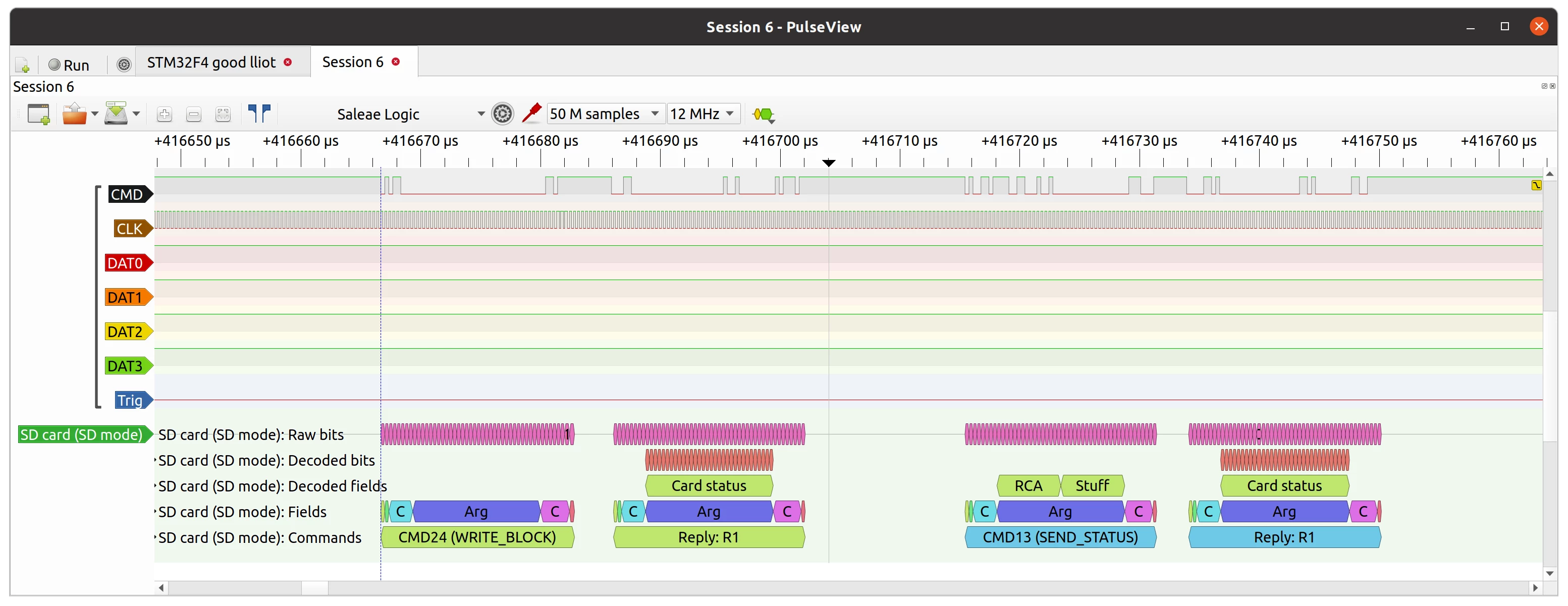

Now, again on NUCLEO-L4A6ZG, if I simply change HAL_SD_WriteBlocks_DMA to HAL_SD_WriteBlocks, I get this:
0693W00000LxcuiQAB.pngSo, when I call HAL_SD_WriteBlocks_DMA on the L4A6ZG, the command is sent but no data is ever sent.

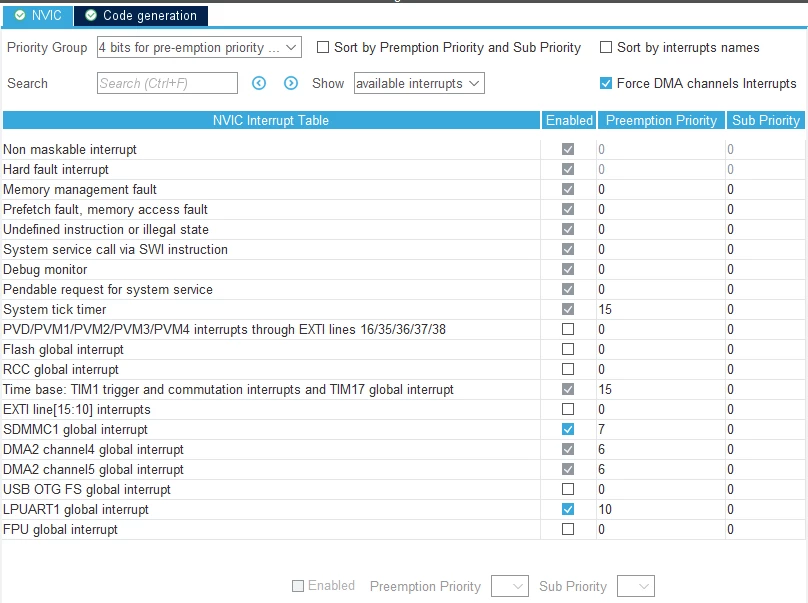

Do these interrupt priorities seem reasonable?
NVIC Interrupt Table	Enabled	Preemption Priority	Sub Priority
Non maskable interrupt	TRUE	0	0
Hard fault interrupt	TRUE	0	0
Memory management fault	TRUE	0	0
Prefetch fault, memory access fault	TRUE	0	0
Undefined instruction or illegal state	TRUE	0	0
System service call via SWI instruction	TRUE	0	0
Debug monitor	TRUE	0	0
Pendable request for system service	TRUE	0	0
System tick timer	TRUE	15	0
PVD/PVM1/PVM2/PVM3/PVM4 interrupts through EXTI lines 16/35/36/37/38	FALSE	0	0
Flash global interrupt	FALSE	0	0
RCC global interrupt	FALSE	0	0
Time base: TIM1 trigger and commutation interrupts and TIM17 global interrupt	TRUE	15	0
EXTI line[15:10] interrupts	FALSE	0	0
SDMMC1 global interrupt	TRUE	7	0
DMA2 channel4 global interrupt	TRUE	6	0
DMA2 channel5 global interrupt	TRUE	6	0
USB OTG FS global interrupt	FALSE	0	0
LPUART1 global interrupt	TRUE	10	0
FPU global interrupt	FALSE	0	0
In case that's too hard to read:
Tesla DeLorean
Guru
April 11, 2022
Look to be reasonable.
