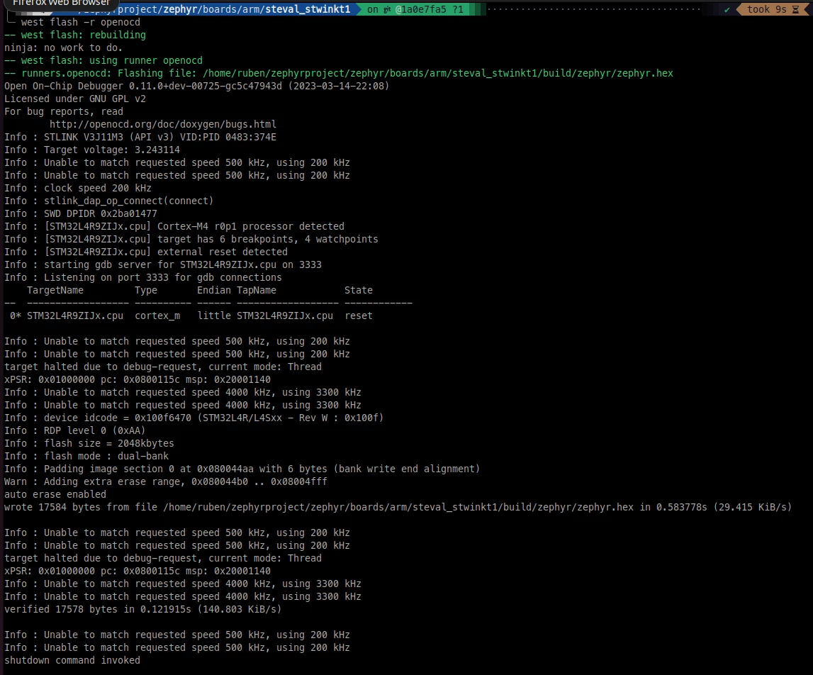

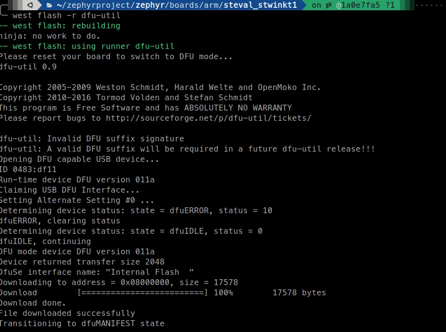

FAQ: Error flashing Zephyr firmware with STLINK-V3MINI (SWD) by openocd runner in steval_stwinkt1 dev kit.
I tried to flash Zephyr Firmware by DFU and I the firmware flashed as I expected.
0693W00000bhHOTQA2.pngIn the other hand, I tried flashing firmware by STLINK-V3MINI something raise an error.
0693W00000bhHQQQA2.pngThis is the contents of board.cmake file:

Also, this is the contents of openocd.cfg file:
# source [find interface/stlink.cfg]
source [find interface/stlink-dap.cfg]
set WORKAREASIZE 0x8000
# transport select hla_swd
# Transport SWD protocol
transport select "dapdirect_swd"
set CHIPNAME STM32L4R9ZIJx
set BOARDNAME STEVAL-STWINKT1
# Enable debug when in low power mode
set ENABLE_LOW_POWER 1
# Stop watchdog counter when halt
set STOP_WATCHDOG 1
# STlink debug clock frequency
set CLOCK_FREQ 4000
# Reset configuration
# Use hardware reset, connect under reset
# connect_assert_srst nedded if low power mode application running (WFI...)
reset_config srst_only srst_nogate connect_assert_srst
set CONNECT_UNDER_RESET 1
set CORE_RESET 0
source [find target/stm32l4x.cfg]

The issue was that in the openocd.cdg file I was written:
source [find target/stm32f4x.cfg] in state of source [find target/stm32l4x.cfg]
So the issue was fixed :grinning_face_with_sweat:
