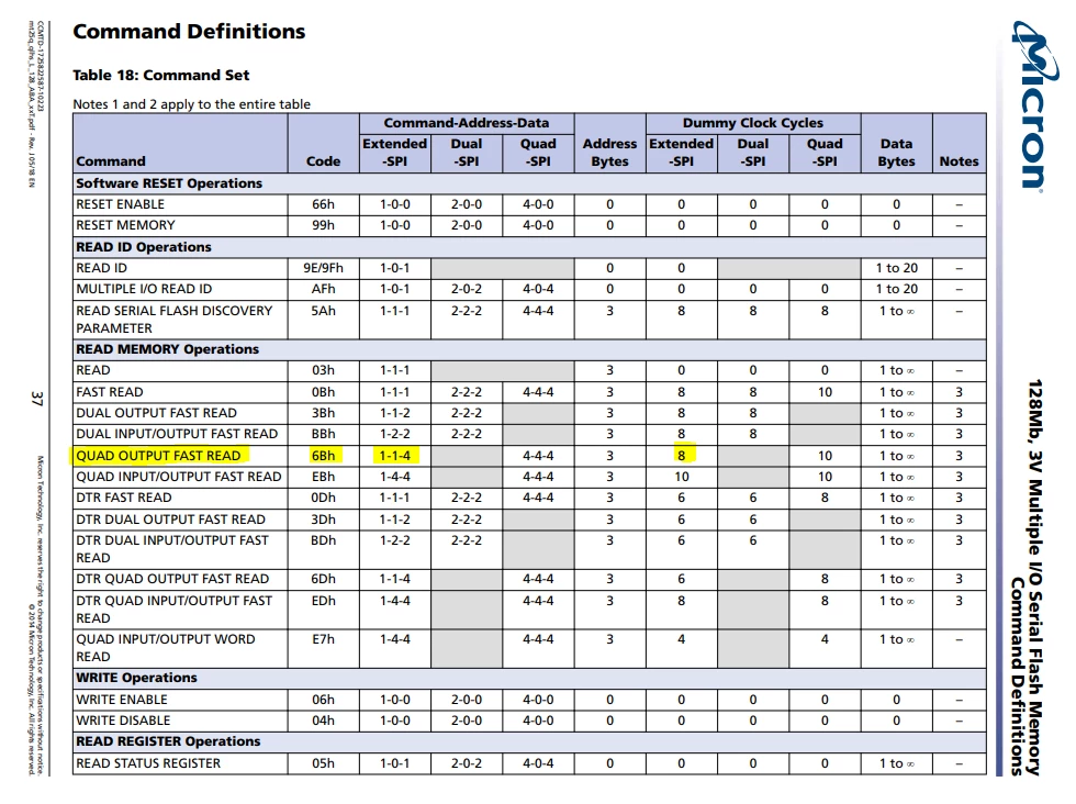

Hi @G_Anastasopoulos ,
Could you please check the Dummy cycle. I noted in the driver code "qspi_flash.c" specifically in the the function "CSP_QSPI_EnableMemoryMappedMode(void)", the command-address-data is set to 1-1-4 which is for extended SPI, and dummy cycle set for 10 in "qspi_flash.h" , which is intended for Quad SPI mode as mentioned in the memory datasheet. However, according to the datasheet, dummy cycle configuration for extended SPI should be 8. Therefore, I suggest changing the "DUMMY_CLOCK_CYCLES_READ_QUAD" to "DUMMY_CLOCK_CYCLES_READ" = 8 in the "qspi_flash.h".
Thank you.
Kaouthar

static uint8_t BSP_OSPI_Read(OSPI_HandleTypeDef *hospi, uint8_t* pData, uint32_t ReadAddr, uint32_t Size)
 OSPI_RegularCmdTypeDef sCommand = {0};
 sCommand.OperationType = HAL_OSPI_OPTYPE_COMMON_CFG;
 sCommand.FlashId = HAL_OSPI_FLASH_ID_1;
 /* Initialize the read command */
 sCommand.Instruction = 0x3B; // DUAL (MOST COMPATIBLE)
 sCommand.InstructionMode = HAL_OSPI_INSTRUCTION_1_LINE;
 sCommand.InstructionSize = HAL_OSPI_INSTRUCTION_8_BITS;
 sCommand.InstructionDtrMode = HAL_OSPI_INSTRUCTION_DTR_DISABLE;
 sCommand.DataMode = HAL_OSPI_DATA_2_LINES;
 sCommand.DataDtrMode = HAL_OSPI_DATA_DTR_DISABLE;
 sCommand.AddressMode = HAL_OSPI_ADDRESS_1_LINE;
 sCommand.AddressDtrMode = HAL_OSPI_ADDRESS_DTR_DISABLE;
 sCommand.DummyCycles = 8;
#ifdef USE_ADR32
 sCommand.AddressSize = HAL_OSPI_ADDRESS_32_BITS;
#else
 sCommand.AddressSize = HAL_OSPI_ADDRESS_24_BITS;
#endif // USE_ADR32
 sCommand.Address = ReadAddr & 0x0FFFFFFF; // Ensure Masking
 sCommand.AlternateBytesMode = HAL_OSPI_ALTERNATE_BYTES_NONE;
 sCommand.NbData = Size;
 sCommand.SIOOMode = HAL_OSPI_SIOO_INST_EVERY_CMD;
