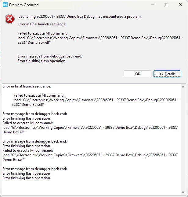

Failed to execute MI command - load .elf file
I have been using a NUCLEO-F413 board to try and understand how to program to user FLASH using the example code in the STMicro repository and STM32Cube to program. However when I now try and program the board I get the below error:
Has me trying to write to the FLASH damaged the program space? If so is it possible to restore it or is the board now dead?

Andrew Neil
Jan 23, 2025 12:50 PM UTC

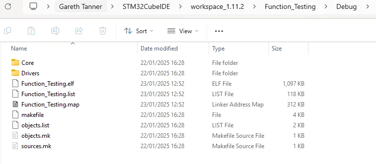

It could be just that the ELF file does not exist ...
GTann.1
GTann.1Author
Jan 23, 2025 12:54 PM UTC
The ELF file does exist.
MOBEJ
Jan 23, 2025 1:25 PM UTC
Hello @GTann.1 ,
To resolve the issue with your NUCLEO-F413 board, please install the STM32CubeF4 package from  ST.com . Then, navigate to the directory Firmware\Projects\STM32F413ZH-Nucleo\Examples\FLASH and open the flash example project using STM32CubeIDE. Build and run the project on your board, and ensure you follow the instructions provided in the README file to make it work properly.

GTann.1
GTann.1Author
Jan 27, 2025 11:16 AM UTC
I have tried this however I still get an error that the .elf file can not be loaded onto the board.
MOBEJ
Jan 27, 2025 1:21 PM UTC
Please uninstall the current version of STM32CubeIDE and reinstall the latest version from ST.com , If you have MDK ARM (Keil) or EWARM (IAR) IDEs available, try running the same project in these environments. These steps will help to identify and isolate the issue.
