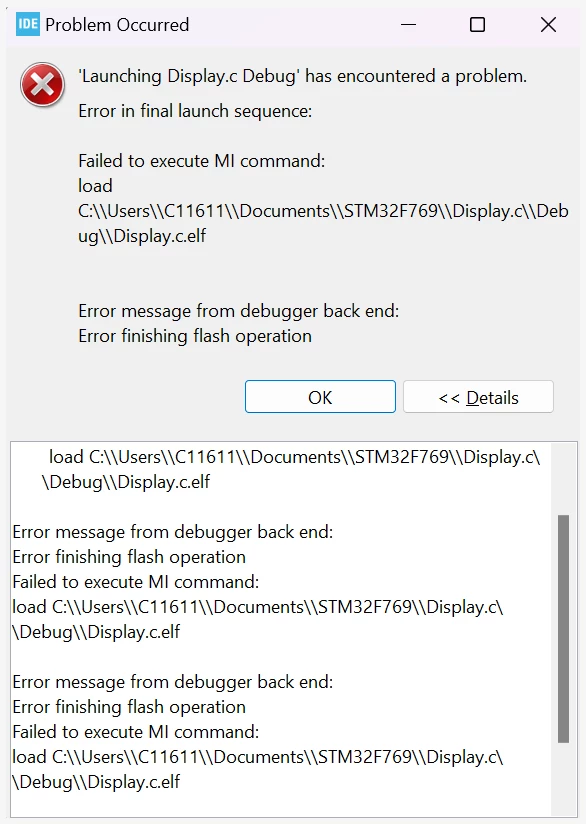

Hi, I've been trying to debug my led toggle code. But I'm getting error like "Error in final launch sequence" and "Failed to execute MI command". I was using STM32F769-Disco board.

@Ratheesh wrote:
I'm getting error like ...
"like" ?
Please be specific: post the actual, complete message you are getting - a screenshot and/or copy & paste from the output log.
Are you sure that your computer is actually seeing the Disco board's ST-Link?
https://community.st.com/t5/stm32-mcus/how-to-solve-debugger-connection-issues/tac-p/698105/highlight/true#M956

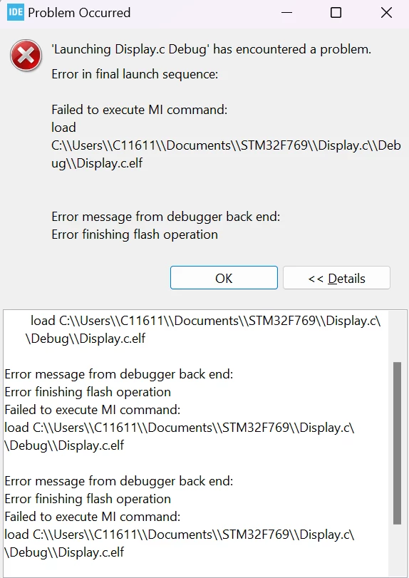

Hi, now I've attached the screenshot of that error message

You can paste into the post - then we can see it more easily:
So it's failing to load the .elf file - ie, your code.
Does that .elf file actually exist? Did you successfully build your project?
And, again, are you sure that your computer is actually seeing the Disco board's ST-Link?
If your computer can't see the ST-Link, then it's clearly not going to be able to use it to load your code...
