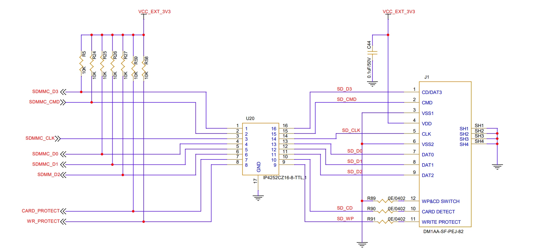

Your faced issue in card initialization may be due to the power supply for the SD card. Many SD cards require a stable 5V power supply to function correctly. If the SD card is not receiving the necessary power, it may not respond properly.
Please verify the power supply requirements for your specific SD card.

          i am using 3.3V with pull up register 10kohm.

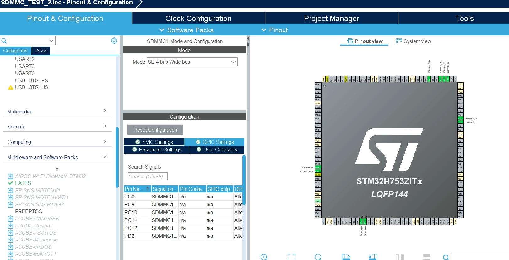

If you have your own board, pls check the connection between the MCU and your uSD card connector and make sure you are configuring correctly your pinout using CubeMX.

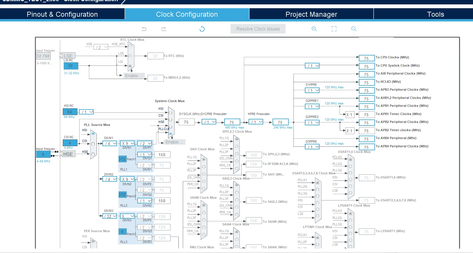

SD_HandleTypeDef hsd1;

 RCC_OscInitStruct.OscillatorType = RCC_OSCILLATORTYPE_HSI;
 RCC_OscInitStruct.HSIState = RCC_HSI_DIV1;
 RCC_OscInitStruct.PLL.PLLSource = RCC_PLLSOURCE_HSI;
 RCC_OscInitStruct.PLL.PLLM = 4;
 RCC_OscInitStruct.PLL.PLLN = 9;
 RCC_OscInitStruct.PLL.PLLP = 2;
 RCC_OscInitStruct.PLL.PLLQ = 1;
 RCC_OscInitStruct.PLL.PLLR = 2;
 RCC_OscInitStruct.PLL.PLLRGE = RCC_PLL1VCIRANGE_3;
 RCC_OscInitStruct.PLL.PLLVCOSEL = RCC_PLL1VCOMEDIUM;
 RCC_OscInitStruct.PLL.PLLFRACN = 3072;
 Error_Handler();
 |RCC_CLOCKTYPE_PCLK1|RCC_CLOCKTYPE_PCLK2
 |RCC_CLOCKTYPE_D3PCLK1|RCC_CLOCKTYPE_D1PCLK1;
 RCC_ClkInitStruct.SYSCLKDivider = RCC_SYSCLK_DIV1;
 RCC_ClkInitStruct.AHBCLKDivider = RCC_HCLK_DIV1;
 RCC_ClkInitStruct.APB3CLKDivider = RCC_APB3_DIV1;
 RCC_ClkInitStruct.APB1CLKDivider = RCC_APB1_DIV1;
 RCC_ClkInitStruct.APB2CLKDivider = RCC_APB2_DIV1;
 RCC_ClkInitStruct.APB4CLKDivider = RCC_APB4_DIV1;
 if (HAL_RCC_ClockConfig(&RCC_ClkInitStruct, FLASH_LATENCY_1) != HAL_OK)
 Error_Handler();

 hsd1.Instance = SDMMC1;
 hsd1.Init.ClockEdge = SDMMC_CLOCK_EDGE_RISING;
 hsd1.Init.ClockPowerSave = SDMMC_CLOCK_POWER_SAVE_DISABLE;
 hsd1.Init.BusWide = SDMMC_BUS_WIDE_4B;
 hsd1.Init.HardwareFlowControl = SDMMC_HARDWARE_FLOW_CONTROL_DISABLE;
 hsd1.Init.ClockDiv = 0;

Your setting should be ok. I understand that you are using your own board ( not ST board).

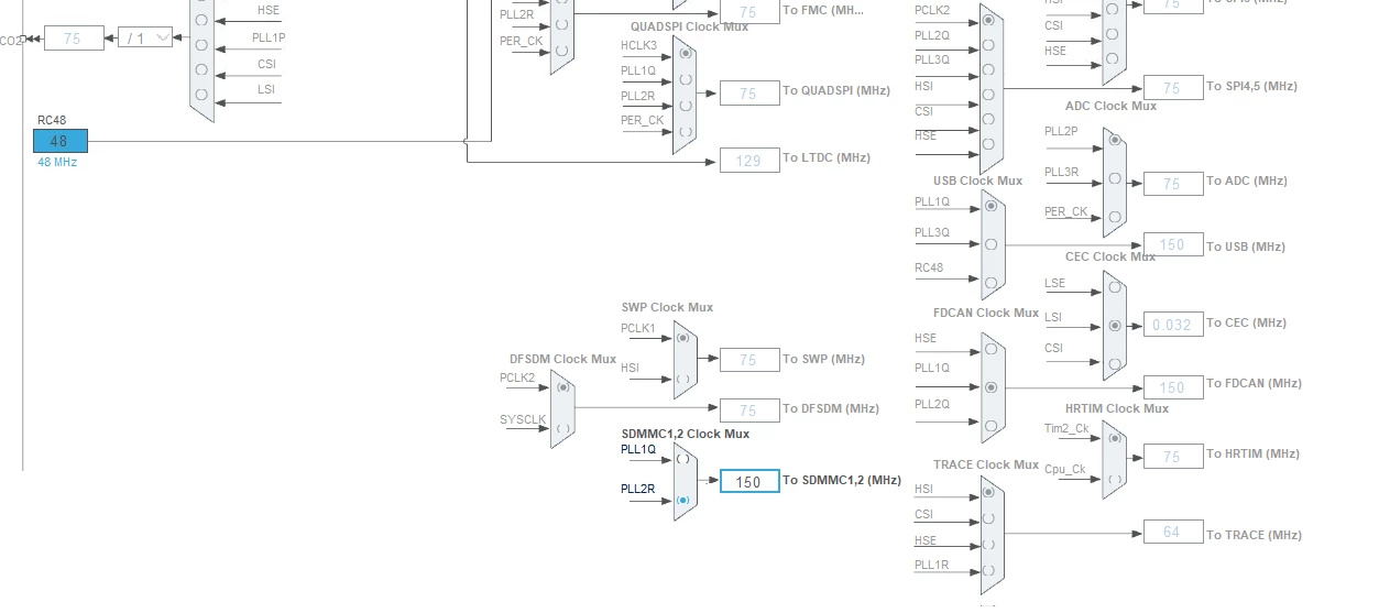

Could you plot the signal SD_CLK and SDMMC_CLK, just after the fail?
