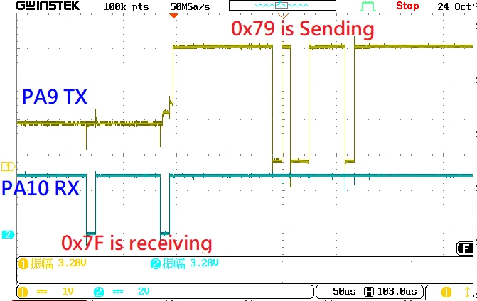

I got a strange, also interesting, problem, while I am using System Memory Boot Mode with STM32F446RE.
Hardware Description
STM32F446, Nucleo-64 Board (PID:0x0421, BID:0x90, Bootloader Version:0x31)
STM32F410 Nucleo-64 Board for comparison
Host Test Utilities:
ST Flash Loader Demonstrator,
AccessPort (just a PC com port test software)
Prolific PL2302 USB to Serial Module (self made)
Configuration:
1 BOOT0 pin: 1 (pull high to 3.3V)
2 BOOT1/PB2 pin: 0(pull down to Gnd)
3 This makes System Memory selected as Boot area.
4 UART1 PA9/PA10 and UART3 PC10/PC11 with pullup 100K Ohm Resistor.
5 UARTx TX/RX connected to RX/TX pins of PL2302
TRY1:
   Use STM32F446
UART1 PA9/PA10 => Flash Loader Demonstrator Failed (''Unrecognised device....Please, restart your device and try again'' )
TRY2:
Use STM32F446
UART3 PC10/PC11 => OK, Flash Loader Demonstrator works!
TRY3:
   Switch to  STM32F410 UART1 PA9/PA10 => OK, Flash Loader Demonstrator works!
TRY4:

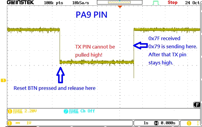

   Back to STM32F446 and PA9/PA10 pins, with still the above setup. Oscilloscope shows the following image:
Problem:
   Due to unknown reason, STM32F446RE PA9 UART1 TX pin is somehow driven low with system memory boot mode pin setup after a reset. This strange phenomena cannot be seen in UART3 PC10 pin, and STM32F410 UART1 PA9 pin.
I've tried that if Boot0 grounded, as normal flash operation, this PA9 driven-low phenomena also cannot not be observed, as the 100K resistor is easily pulled it VCC. I believe this is somehow related to the code in the system boot memory, perhaps not properly configured.
Work-Around:
   1. Set PA9 TX pin with pull-up resistor down to few kOhm(1K ~ 4.99K Ohm) does the job, with the cost of power consumption.
   2. If I use Com Port Test Software, like AccessPort,  This PA9 driven-low after reset causes the host to receive a 0x00 byte equivalently, hence Flash Loader Demonstrator fails to recognize the device. If this 0x00 byte is omitted, we can still send 0x7F to make UART1 enter boot mode, as I can read chip information using 0x00FF and 0x01FE. Hence a custom flash loader application is still possible.
Does any have similar experience? Or I just got a damaged F446??
Thanks for reading this post!

waclawek.jan
Oct 24, 2017 9:01 AM UTC
Posted on October 24, 2017 at 11:01
In the 'F446, probably OTG_FS_GCCFG.VBUSBSEN is switched on, that involves a
https://community.st.com/0D50X00009XkaC1SAJ
As you've said, not a showstopper, as it can be worked around by an external pullup - and AN2606 does call for pullups on Tx/Rx for bootloading albeit for 100kOhm which would be insufficient for this case.
I believe this ought to be properly documented in AN2606 for all STM32 models which use the same OTG module and DFU bootloader with enabled VBUSBSEN potentially conflicting with the USART bootloader.

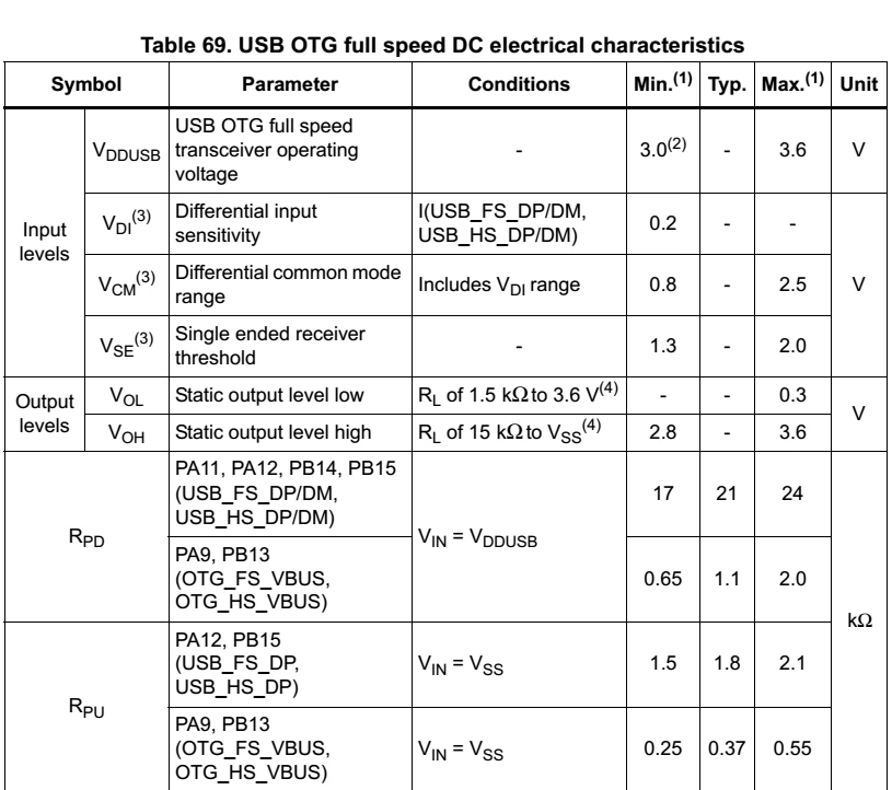

Zt Liu
Zt LiuAuthor
Senior III
Oct 24, 2017 12:36 PM UTC
Posted on October 24, 2017 at 12:36
Thanks for this quick reply!!!
I just check that my F410RE has no this corresponding USB functionality,
it's very likely that, as you said, PA9 as VBUS pin is somehow strongly pull-down.
However, as your post has pointed out, this amazingly strong pull-down character is also not observed as spec stated.
(Otherwise, my external pull-up 1K would not work!)
(F446 spec belowed.)
I really hope that this could be properly documented.....
Guess you're right about that in system boot mode, both UART1 and USB OTG  FS are both enabled which cause PA9 to strongly pull-down in the beginning after reset.
Thanks again!
.Zt
