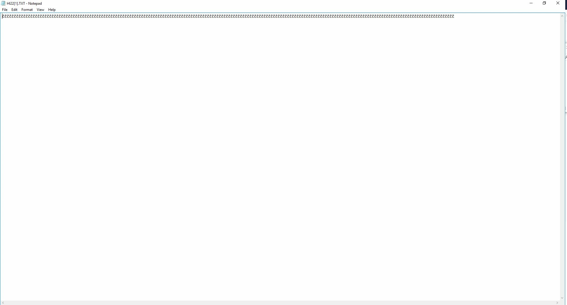

If I write an integer as in the following:
uint16_t array[192];
UINT wbytes; // needs to be 32-bit wide
res1 = f_write(&SDFile, &array[0] , sizeof(array), &wbytes); // write whole array
In my case:
uint16_t wtext [192] = {[0 ... 191] = 1000};
UINT wbytes;
res1 = f_write(&SDFile, &wtext[0], sizeof(wtext), &wbytes);
Then I get the following in the text file:
Full code:
UINT wbytes;
if(FATFS_LinkDriver(&SD_Driver, SDPath)==0){
res = f_mount(&SDFatFS,SDPath,1);
if(res == FR_OK){
res2 =f_open(&SDFile,''hitxt'',FA_OPEN_APPEND | FA_WRITE);
f_close(&SDFile);
Although when I write a character I can see the correct data in the text file.

Perhaps look at the file in a viewer that can show you the binary content.
1000 as 16-bit words would appear as
E8 03 E8 03 ...
Not printable ASCII words, not human readable. Data is represented in a machine readable form, the byte order would depend on the endian format the machine uses.
int i = 1000;
char buffer[12];
int len = sprintf(buffer, '%d ', i); // ASCII sprintf() or itoa()
res1 = f_write(&SDFile, buffer , len, &wbytes);
