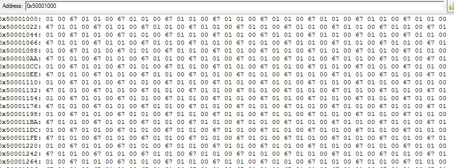

I am seeing this(hpcd->OUT_ep->xfer_buff) buffer populate with additional/non-existent characters when sending messages to the board. As soon as I send a message to the board, this buffer populates with the additional characters (not the sent character), then I allow the HAL_PCD_DataOutStageCallback function to call and this buffer fills with the message that I sent and keeps the additional/non-existent characters at the end. I have checked and seen that the actual memory register space (USBx_DFIFO(0)) that receives these messages filled with the actual sent character and non-existent characters (it does not "fill" this 1000 byte space. It fills the first few bytes that contain my sent message and the additional characters). This space being 0x50001000 on my stm32f7xx chip. This space is set to zero before enumeration, then after enumeration this memory space fills in an interesting way, that changes each time a message is sent. I will attach an image. The 00 and 01 remain consistent, however, the 67 that you see changes after each message to a new random character.

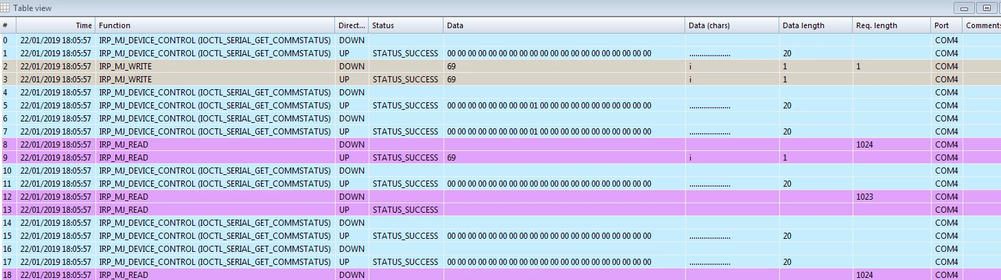

​I use a serial port monitor provided by Eltima. I will attach a screenshot showing that only an "i" was sent. However, my hpcd->OUT_ep->xfer_buff and eventually my UserRxBuffer fills with "i€‘" also known as 0x69 0x80 0x91. This is when using terraterm. But if I were to use a different terminal program, I would see a different message.
I have actually solved this issue by saving the length of the message received in a static variable to access later. This length gets passed through the callback structures of the interrupt. Previously I had been calculating the length of the message buffer with a strlen command. The moral of the story being, don't ever calculate the length of the received buffer on your own when using STM32F7 USB device drivers. Use the length that they give you in the callback. The read buffer gets filled with all kinds of nonsense that varies depending on all kinds of factors, but the beginning of it will be the correct message.0690X000006DCZAQA4.png

> (USBx_DFIFO(0))
>0x50001000
You are not supposed to read that area through the debugger, doing so messes up the internal registers of the OTG module.

Jan 22, 2019 11:36 PM UTC
