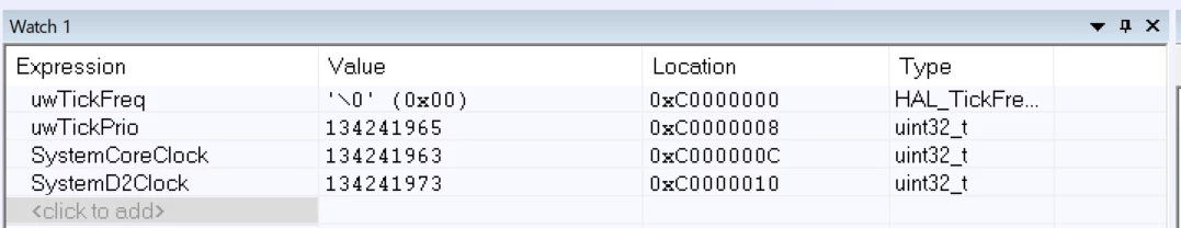

Above is my skeleton code. If I comment out MX_USB_DEVICE_Init(), the device starts up and runs fine. It doesn’t do anything, but I know that it’s hitting the main loop. If I don’t comment it out the program stalls during SystemClock_Config. Following that down I find it’s getting stuck here in HAL_InitTick
if((uint32_t)uwTickFreq == 0UL)
return HAL_ERROR;

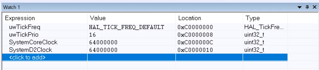

Looking at the memory view in the debugger shows this
When it should look like this
I don’t think this issue is specific to add USB functionality. I think that more things are being added to memory and it’s causing some sort of memory clobber.
