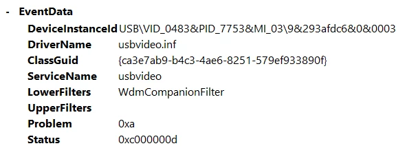

Unfortunately I have additional problems
Windows is still complaining, that the camera cannot be started.
It complains about a wrong parameter being transmitted
Code 0x0A Status 0xC000000D
Do you have an idea, what the problem might be?

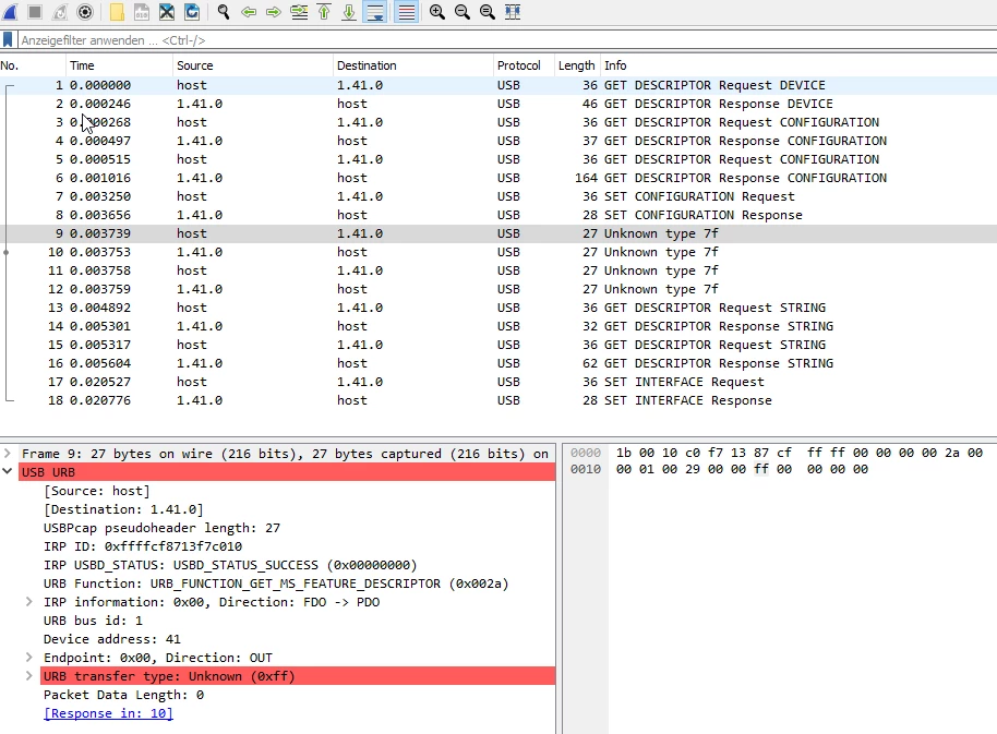

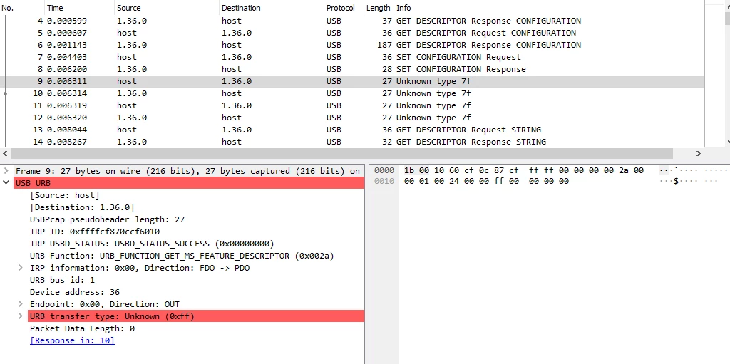

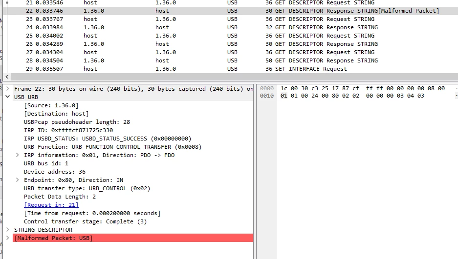

I have a wireshark USB trace. There are multiple strange packets:
_legacyfs_online_stmicro_images_0693W00000bjxw7QAA.pngAnd a malformed packet
_legacyfs_online_stmicro_images_0693W00000bjxwCQAQ.pngThe rest of the packets are related to MSC storage, i think

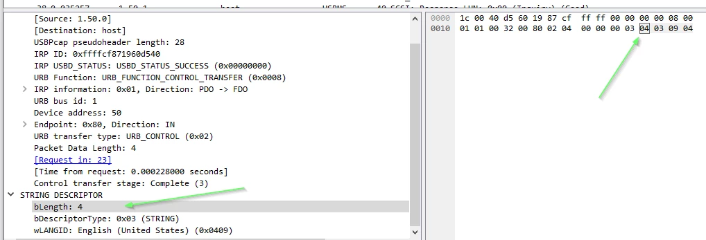

Johannes
JohannesAuthor
Senior
May 12, 2023
If a package is "ok", this seems to be the position is the lengh information of the payload
_legacyfs_online_stmicro_images_0693W00000bjyGDQAY.pngbLengh = 4, 1 byte "bDescriptor type" and 2 bytes payload = 4 bytes.
In the malformed package
bLength = 4, but only the bDescriptor is following and 2 bytes are missing
