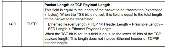

I'm writing an ethernet driver and the FL field in TDES3 seems to not do anything.
0693W00000FAmTkQAL.jpgI am not setting the TSE bit.
The packets seem to always leave with a size that is the sum of both B1L and B2L (if used).

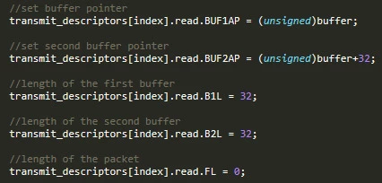

In my last test I set it up like so:
0693W00000FAmUdQAL.jpgAnd it still worked.
No matter the combination of B1L, B2L and FL, it always just sends the totality of the buffers.

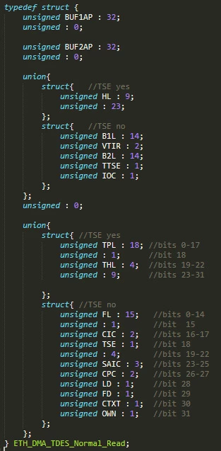

My struct for the descriptor is as far as I can tell correct:
0693W00000FAmTzQAL.jpgI have gone over it a few times, and the other flags in TDES3 are getting set correctly as well so I'm pretty sure it's correct.
I could see this as perhaps being used for a >1 descriptor transmit, but I have yet to use that, or jumbo packets, or giant packets - and even for giant packets, B1L and B2L both have 14 bits, and FL has 15, which means MAX(B1L)+MAX(B2L)==MAX(FL), which makes it seem to me like you don't even need multiple descriptors to send the maximum size packet of ~32kb. That's not relevant though because even with jabber disabled, transmit can only go up to 16kb, for which only 1 buffer is required. Plus the value can be zero and still work, which makes me think it wouldn't work even for >1 descriptor transmit.
Regardless I would just like to know whether I should be concerned just setting it to 0, or what I should actually set it to. The HAL seems to set it but since it doesn't seem to do anything, a little clarification would be greatly appreciated.
