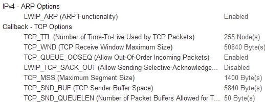

When increasing the number of instance intitilized, during communication controller will either run into hardfault or on the client side transmission will fail, from this i have learnt it is because of wrong memory configuration.
Currently my configuration is able to run on a maximum number of 9 clients at a time.

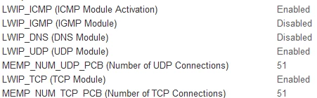

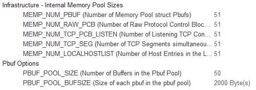

Iam able to run the 50 server simultaneously, for optimizing memmory i want to understand the exact memory configuration required.
My Findings and configurations
Correct me if iam wrong, each instance requires there own tx and rx descriptors for simultaneous communication minimum 96 bytes for each.
Pbuf is for handling all the incoming and outgoing data which highly depends on the number of bytes incoming
Rx pool i dont have a clear differenciation on this with Pbuf,
The configurations are based on the referance from the above link, and i have modified some parameters which thought necessary for increasing the number of instancs.

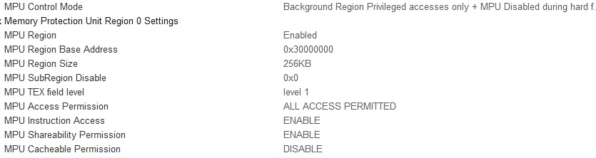

MPU configuration
Linker configuration
RAM_D2 (xrw) : ORIGIN = 0x30000000, LENGTH = 288K
.lwip_sec (NOLOAD) :
. = ABSOLUTE(0x30000000);
*(.RxDecripSection)
. = ABSOLUTE(0x30001400);
*(.TxDecripSection)
. = ABSOLUTE(0x30002800);
*(.Rx_PoolSection)
} >RAM_D2

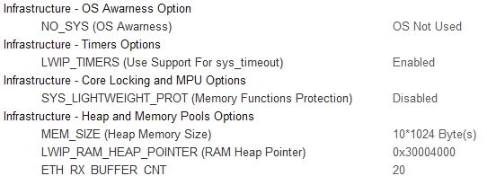

Hello @sarun ,
lwip heap memory size is the amount of memory allocated for the lwip stack to handle network data. It can be configured by the macro MEM_SIZE, which defines the size of the heap memory in bytes. The default value of MEM_SIZE is 1600 bytes, but it can be increased if the application sends a lot of data that needs to be copied. The heap memory can also be assigned to a specific region by using the macro LWIP_RAM_HEAP_POINTER, which points to the start address of the heap memory.
Each TCP PCB consumes a certain amount of memory. Increasing MEMP_NUM_TCP_PCB will directly increase the memory usage of the lwIP stack. This includes memory for the PCB structures themselves and associated buffers for data transmission and reception.
lwIP uses memory pools for various structures, including PCBs. Increasing the number of PCBs will require larger memory pools, which can lead to higher static memory allocation.

and i have a small doubt are PCBs allocated in the LWIP heap?
Aug 1, 2024 11:14 AM UTC
Hello @sarun ,
answering "and i have a small doubt are PCBs allocated in the LWIP heap?"
in fact, it is indeed allocated in the LWIP Heap using the tcp_alloc() function in for TCP as an example that function calls memp_malloc() which allocates memory in the LWIP Heap(dynamically).
