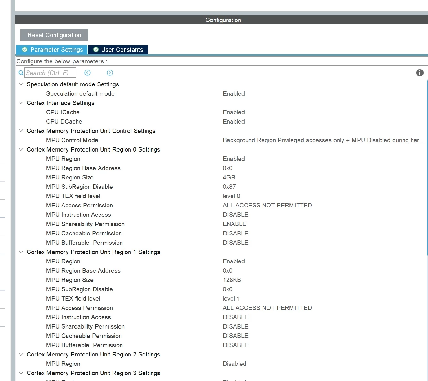

thanks for the reply, I'm trying to use NetXDuo, but I can't find a good example to map the H7 memories
magianfAuthor
July 8, 2025
Hi all,
is there anyone using NetXDuo on the STM32H747 micro that can help me with the CORTEX_M7 MPU configuration settings.
thanks a lot
