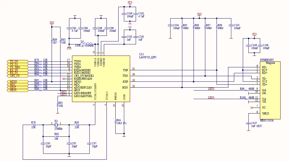

Hello.
I want to make an UDP communication using mySTM32F407 based board, where the PC forms the server side. I checked most of the posts related to the Ethernet+F407 topic, but could not find any comments that could have lead me in the right direction. The most relevant discussion is this one:

Compiled and loaded it, started the echootool with /p udp /s commands,however i wasunable to get the communication between the PC and the board. Here is the schematic i used to interface the MCU: 0690X00000605OzQAI.png Any tips? Is there anyone who could help me? Anyone who faced the same problem? Thank you in advance. Best regards, �?kos #cube #discovery #stm32f4 #lwip #dis-bb

PIN10 PHYAD0 is unconnected and has internal PULLDOWN, so I think your PHYADD is 0.

Hi , I had the same problem , I just solved it
I have the same hardware with LAN8720 phy IC and it didn't work with HAL , it was working good with STL. However I disabled the autonegotiation and now the problem is solved instead of
//heth.Init.AutoNegotiation = ETH_AUTONEGOTIATION_ENABLE;
I added those three lines in the low_level_init()
heth.Init.AutoNegotiation = ETH_AUTONEGOTIATION_DISABLE;
heth.Init.Speed = ETH_SPEED_100M;
heth.Init.DuplexMode = ETH_MODE_FULLDUPLEX;
also added those lines at the end of the HAL_ETH_MspInit() as you did.
GPIO_InitStruct.Pin = GPIO_PIN_2;
GPIO_InitStruct.Speed = GPIO_SPEED_FREQ_HIGH;
HAL_GPIO_Init(GPIOE, &GPIO_InitStruct);
HAL_GPIO_WritePin(GPIOE, GPIO_PIN_2,GPIO_PIN_RESET);
HAL_Delay(10);
HAL_GPIO_WritePin(GPIOE, GPIO_PIN_2,GPIO_PIN_SET);
HAL_Delay(10);
and now the problem is solved , it seems that HAL doesn't support the autonegitiation for the LAN8720 , and the negotiation code is wrote for the ''DP83848'' which probably the PHY IC on the new nucleo boards, as I noticed that it read and write wrong values from wrong registers , I don't really know , also I debugged the STL code I found that after negotiation it continue to the default values (full duplex , 100M)not that values from the LAN8720, So I did the same and the problem is solved. I really hope any expert tell us what's the real problem , is the HAL_eth is wrote only for DP83848 or we have wrong configurations ?!! taking in consideration that I took the configurations from STM32cubeMX configuration tool , but it doesn't solve the problem , it only solved when I disabled the autonegotiation. Note : gw_addr is the address of the gateway in your network , because I read part of your code and it have the ip_addr the same as gw_addr.

thank you for your feedback. Finally, i could manage to make the Ethernet work. I created a plain project using the CubeMX with the following properties: DHCP disabled->static ip is defined auto negotiation enabled MX_LWIP_Process() shall be added in the while(1) interrupt registers are commented out:
// HAL_ETH_ReadPHYRegister(&heth, PHY_MICR, ®value);
// regvalue |= (PHY_MICR_INT_EN | PHY_MICR_INT_OE);
// /* Enable Interrupts */
// HAL_ETH_WritePHYRegister(&heth, PHY_MICR, regvalue );
// /* Read Register Configuration */
// HAL_ETH_ReadPHYRegister(&heth, PHY_MISR, ®value);
// regvalue |= PHY_MISR_LINK_INT_EN;
// /* Enable Interrupt on change of link status */
// HAL_ETH_WritePHYRegister(&heth, PHY_MISR, regvalue)
HW reset is added in theHAL_ETH_MspInit
GPIO_InitStruct.Pull = GPIO_PULLUP;
GPIO_InitStruct.Speed = GPIO_SPEED_LOW;
HAL_GPIO_WritePin(GPIOE, GPIO_PIN_2, GPIO_PIN_RESET);
HAL_Delay(50);
HAL_GPIO_WritePin(GPIOE, GPIO_PIN_2, GPIO_PIN_SET);
HAL_Delay(50);
I also added theudp_echoclient.c andudp_echoclient.h files in the project in order to test the udp communication. Through theudp_echoclient_connect(); andudp_client_send(); functions i was able to communicate with the GUI (running on the PC), however theudp_receive_callback is not called when a package sent from the GUI, even tho with
udp_recv(upcb, udp_receive_callback, NULL)
function i defined the receive callback in theudp_echoclient_connect(void) function. Any tips? Best regards.
