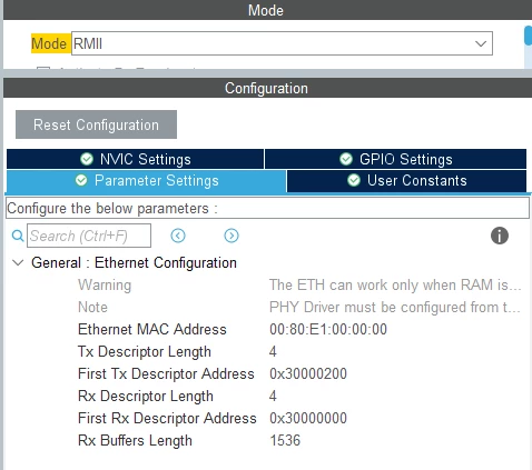

I'm having the same problem with STM32H723ZG, with our own board, Ethernet can only be connected after using ST link to download the code (either by "debug" or "run"). After power cycle the board, it won't connect anymore, reset button didn't help.  I tried your change to uncomment out "#define DATA_IN_D2_SRAM"
and it didn't help either. Checking LWIP echo servo example, it also has "#define DATA_IN_D2_SRAM"
commented out but okay to connect after power up with Nucleo STM32H723ZG Eval board. But running the same
example code on our board, it works after download but not after power up.
I'm using Hal driver FW1.11.1.. How do you make memory dump using Cube programmer? The ST link utility doesn't
work with this H7 chip. Anything else I should check?
Thank you.

This could be due to some miss-configuration of the MPU causing it to fail at run time it seems like the Ethernet is unable to access its DMA buffer descriptors so i suggest you check the configuration of the MPU and then place the descriptors manually in the D2_SRAM this is explained in details in the following article .if you still facing this issue it will be helpful to know about your configuration and changes to the Linker file .

What I changed was RMII pins from low speed to very high.  After that, right after power cycle the board, pressing reset can get Ethernet connection. Then we made hardware change to add a delay to the reset circuit.  Now power cycle the board works too.  I'm not totally convinced that this is the root cause.  You would think pin speed may affect the connection performance but should still allow connection, right?
Here are the configurations of our system:
Not using RTOS, using lwIP.
Using external crystal 25mhz, not same as Eval board that from STlink, so RCC select HSE Crystal/Ceramic Resonator instead of BYPASS clock source.
CPU set as 550mhz.
MPU setting: flash.ld
/* Specify the memory areas */
MEMORY
ITCMRAM (xrw) : ORIGIN = 0x00000000, LENGTH = 64K
DTCMRAM (xrw) : ORIGIN = 0x20000000, LENGTH = 128K
FLASH (rx) : ORIGIN = 0x08000000, LENGTH = 1024K
RAM_D1 (xrw) : ORIGIN = 0x24000000, LENGTH = 320K
RAM_D2 (xrw) : ORIGIN = 0x30000000, LENGTH = 32K
RAM_D3 (xrw) : ORIGIN = 0x38000000, LENGTH = 16K
Descriptors are in D2_SRAM area
What else I could missing?  Any manual changes that I need to make?

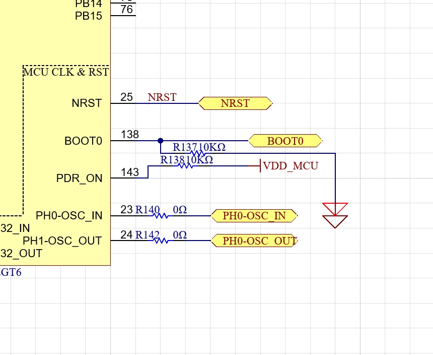

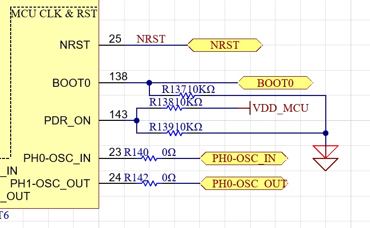

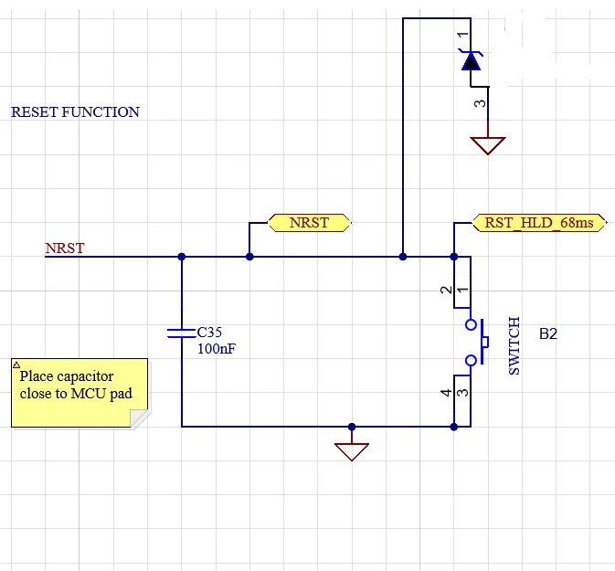

Here are two changes made in the hardware:
one was PDR_ON signal Pin 143 had two resistors R138 10k to VDD and R139 10k to ground. Change made to remove R139 to ground.
Before
After

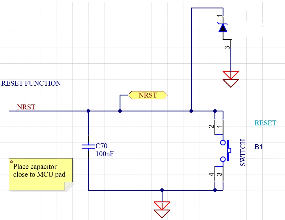

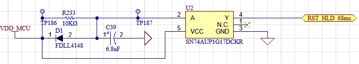

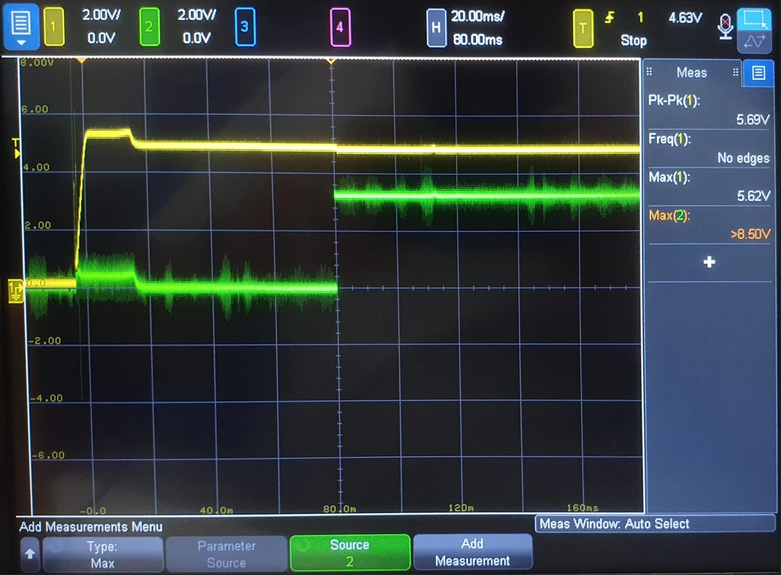

2nd change was to add the delay to the RST pin to keep it stay grounded for 68ms upon power up.
Before change:
After change
Let me know what you think.  Appreciate your help.
Feb 1, 2024 4:17 PM UTC
Hello @ETong.1 ,
  1. can you confirm that the modification to the RST circuit inserted the 68ms you which to have if you can send the snapshot of the scope showing the behavior of the RST ?
  2. why did you remove the resistor connecting the PDR_on to the ground ?is there a practical reason behind this change ?
Best Regards
ETong.1
ETong.1Author
Feb 1, 2024 8:54 PM UTC
Hi @STea ,
1. Here is the scope shot of RST:
On the scope ch1 shows the 5v signal with no delay. Ch2 shows the 3.3v signal which is delayed and used to hold the NRST pin Low for that time. (~68ms theoretical, measured ~80ms).

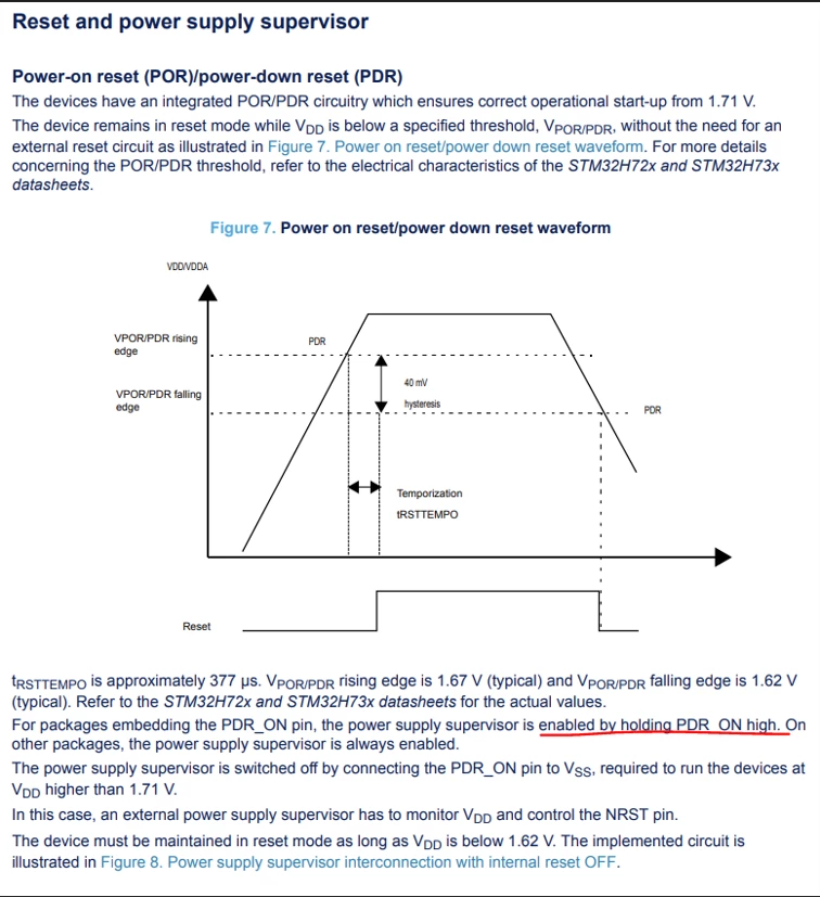

2. Hardware designer found it from this ST application note:
https://www.st.com/resource/en/application_note/an5419-getting-started-with-stm32h723733-stm32h725735-and-stm32h730-value-line-hardware-development-stmicroelectronics.pdf
For packages embedding the PDR_ON pin, the power supply supervisor is enabled by holding PDR_ON high. Thus, the resistor connecting PDR_ON to ground was removed.
Thanks
