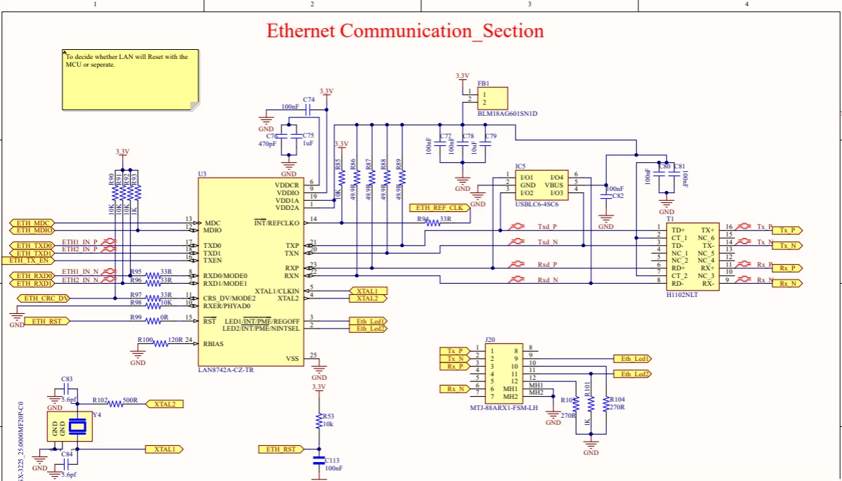

Hii All,
I am working on a custom PCB based on the STM32H747IITX MCU, and I am facing an issue with the Ethernet interface.
The Ethernet connection is currently not working on my custom board. I have checked the basic hardware connections, but I am unable to identify the root cause.
I have attached the Ethernet schematic of my custom PCB for reference.
Could someone please help me review the schematic and suggest what I should check?
In particular, I would appreciate guidance on:

Schematic looks okay on that side, so can’t say if your STM32 side and GPIO setup / alternate functions are correct.
Except for one resistor value at RBIAS pin: you have 120R, I think there should be 12k1 - but I don’t remember what this “bias resistor” actually does… check datasheet: no description * of RBIAS, but it’s always 12k1.
* I absolutely hate that when no description is given what such a resistor does, and even worse it it’s not a super-common value.
EDIT: what is actually working? At least the MDIO interface? Check that first, then if the REF_CLK is actually there. Use scope...

According to the LAN8742A datasheet, the RBIAS pin requires a 12.1 kOm resistor to ground.

junagadhAuthor

Andrew Neil
Sep 7, 2026 9:06 AM UTC
This is a custom board,
So, again, please post the schematic.

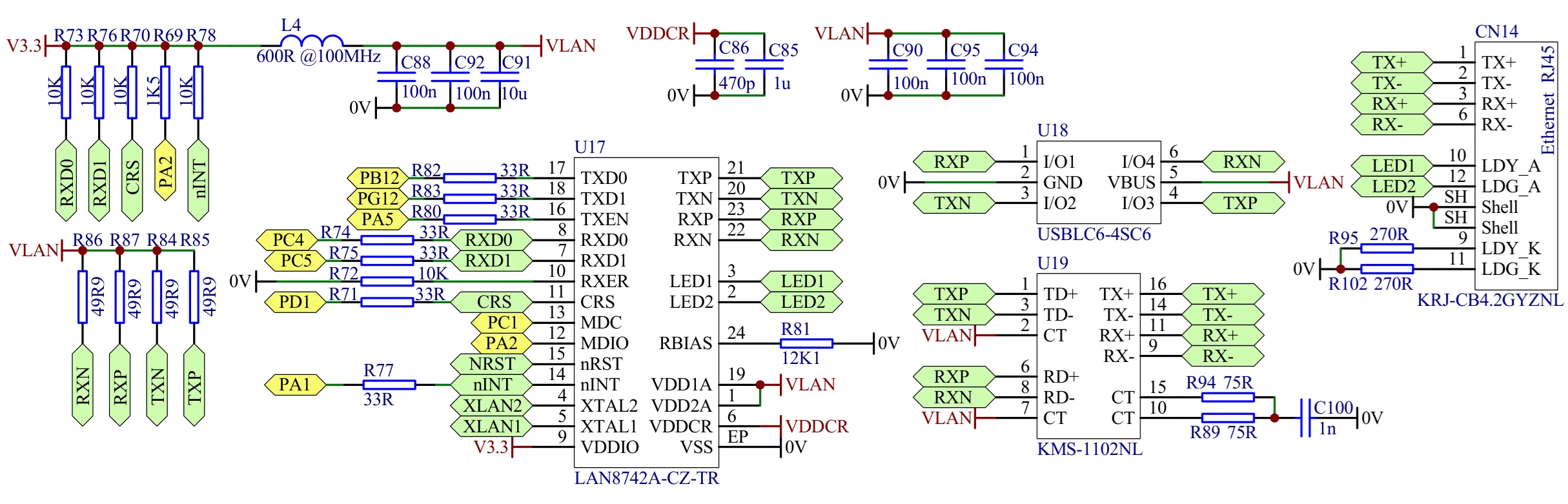

rich.g.williams
Senior
Sep 8, 2026 8:48 AM UTC
compare your schematic with this ST circuit:-
