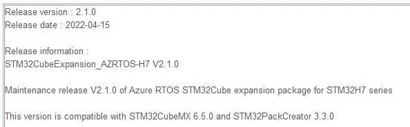

Hi Chekib Hammami,
I also updated AZRTOS-H7 to V2.1.0, it still complains the compatible issue. My cubemx version is v6.5.0.
MWB_CHaAuthor
Apr 18, 2022 7:41 AM UTC
Hi @Community member​ ,
Servers sync might take some time and then this warning message will disappear from STM32CubeMX 6.5.0.
Kind Regards,
