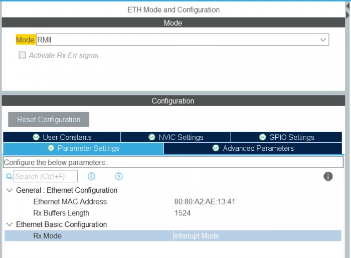

I have an STM32F407 with the ethernet PHY DP83848.
I cannot ping the device if I'm using the LwIP because I'm facing some errors.
I belive that this can be an bug in STM32CubeIDE 1.9.0.
I do the following steps to reproduce the error.
  1. I start up my PCB board
  2. I let the initialization do its job and I get no error back.
  3. I plugin my ethernet cable
  4. I ping a random device with a random number

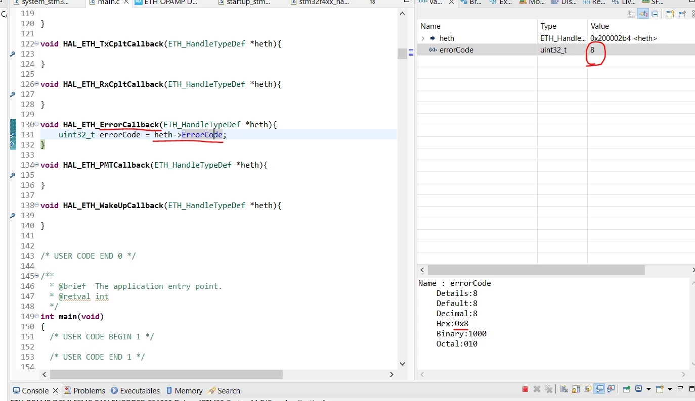

Then my activity LED blink on the DP83848 and then I get an interrupt.
I get the error code 0x8. That means I'm facing DMA issues. But why?

My STM32F407 does not have DMA for Ethernet. What should I do now? Is this a bug?

void HAL_ETH_ErrorCallback(ETH_HandleTypeDef *heth){
	uint32_t errorCode = heth->ErrorCode;

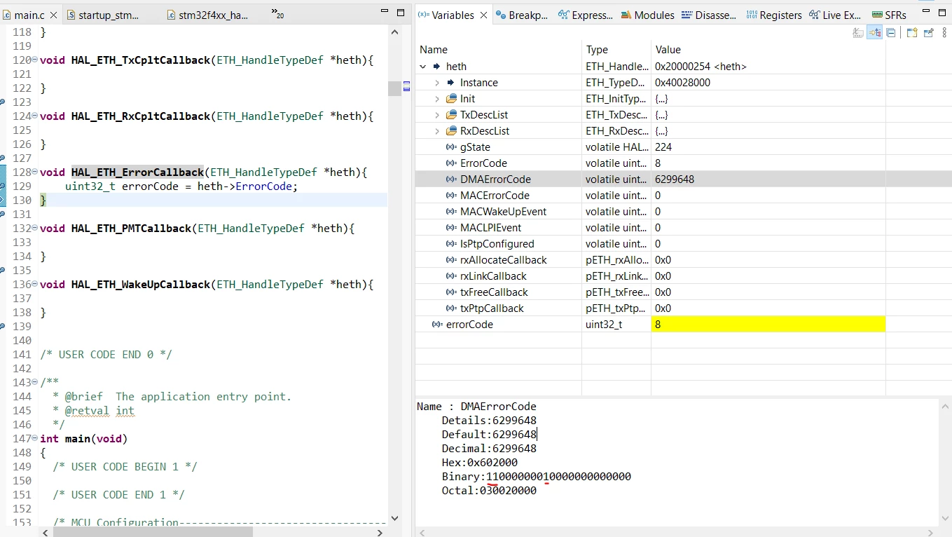

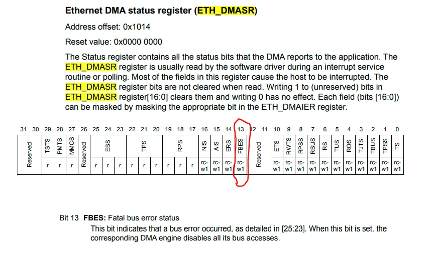

Here is more information. I found a DMA error code.
0693W00000LyBzOQAV.pngHere comes the error code from. See arrow.
/* ETH DMA Error */
 if (__HAL_ETH_DMA_GET_IT(heth, ETH_DMASR_AIS))
 if (__HAL_ETH_DMA_GET_IT_SOURCE(heth, ETH_DMAIER_AISE))
 heth->ErrorCode |= HAL_ETH_ERROR_DMA;
 /* if fatal bus error occurred */
 if (__HAL_ETH_DMA_GET_IT(heth, ETH_DMASR_FBES))
 /* Get DMA error code */
 heth->DMAErrorCode = READ_BIT(heth->Instance->DMASR, (ETH_DMASR_FBES | ETH_DMASR_TPS | ETH_DMASR_RPS)); <<--- HERE!
 /* Disable all interrupts */
 __HAL_ETH_DMA_DISABLE_IT(heth, ETH_DMAIER_NISE | ETH_DMAIER_AISE);
 /* Set HAL state to ERROR */
 heth->gState = HAL_ETH_STATE_ERROR;
 else
 /* Get DMA error status */
 heth->DMAErrorCode = READ_BIT(heth->Instance->DMASR, (ETH_DMASR_ETS | ETH_DMASR_RWTS |
 ETH_DMASR_RBUS | ETH_DMASR_AIS));
 /* Clear the interrupt summary flag */
 __HAL_ETH_DMA_CLEAR_IT(heth, (ETH_DMASR_ETS | ETH_DMASR_RWTS |
It looks like DMA is disabled for ETH?

DMårtAuthor
Lead
Apr 18, 2022 5:12 PM UTC
The RX buffer has STM32CubeIDE self been generating code for.
There is no ST Ethernet example for the 407 processor.
I think I just have discovered a bug in STM32CubeIDE!
