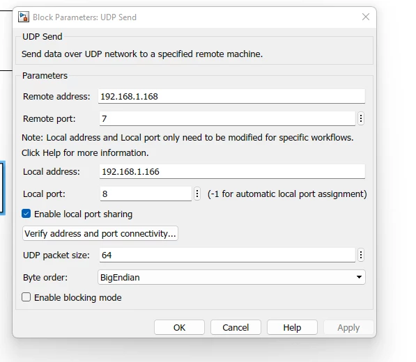

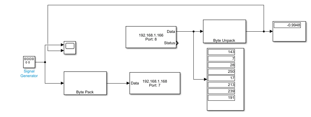

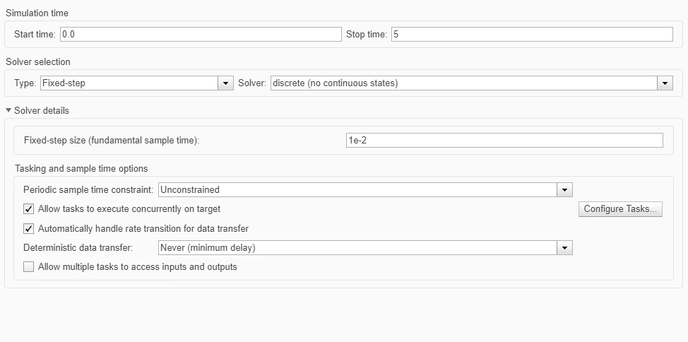

for the PC I'm using Wireshark to capture the frames, and MATLAB SIMULINK to receive and send data from the instrumental library its time base is the timestamp configured in the solver, I'm sending a sine wave with 1Hz frequency, actually the datatype is a double then we are sending 8 bytes each 0.01 seconds

Would expect matlab and windows to be the primary source of delays here--neither is guaranteed to respond quickly.

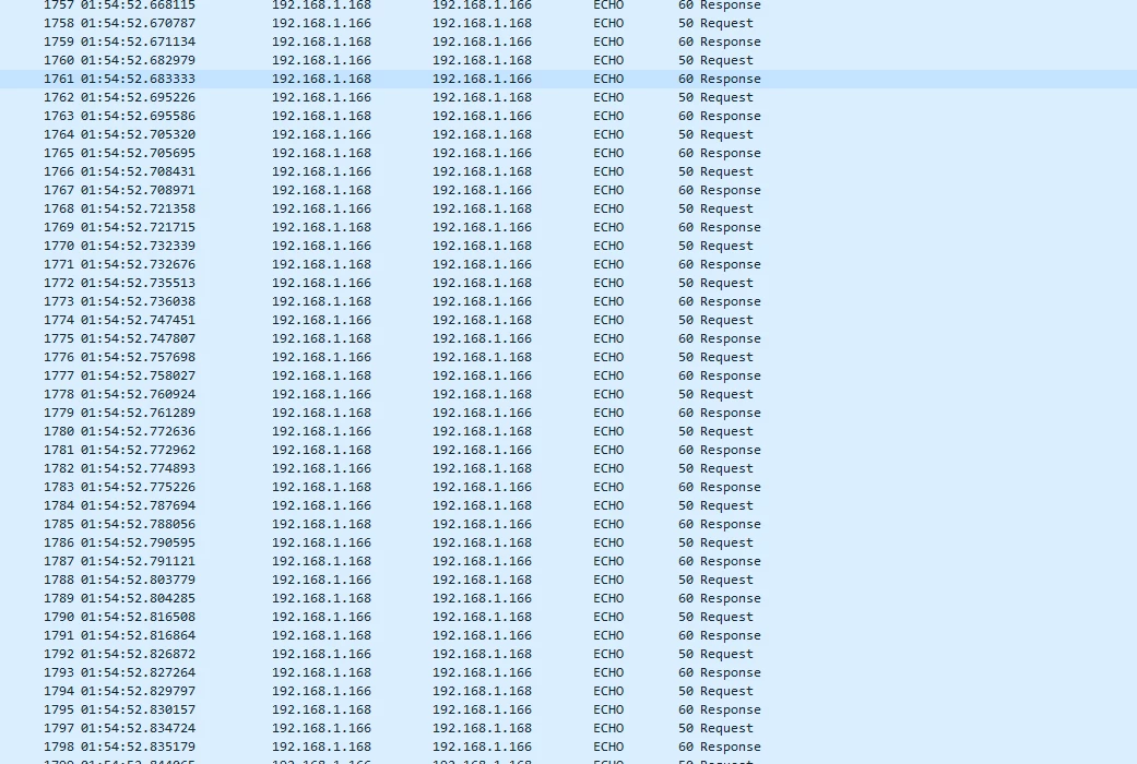

More details on the timing would be interesting. Where are the 0.5-1ms values being picked from? Screenshot or similar.

the screenshot about the delay between the request and response joined below:
