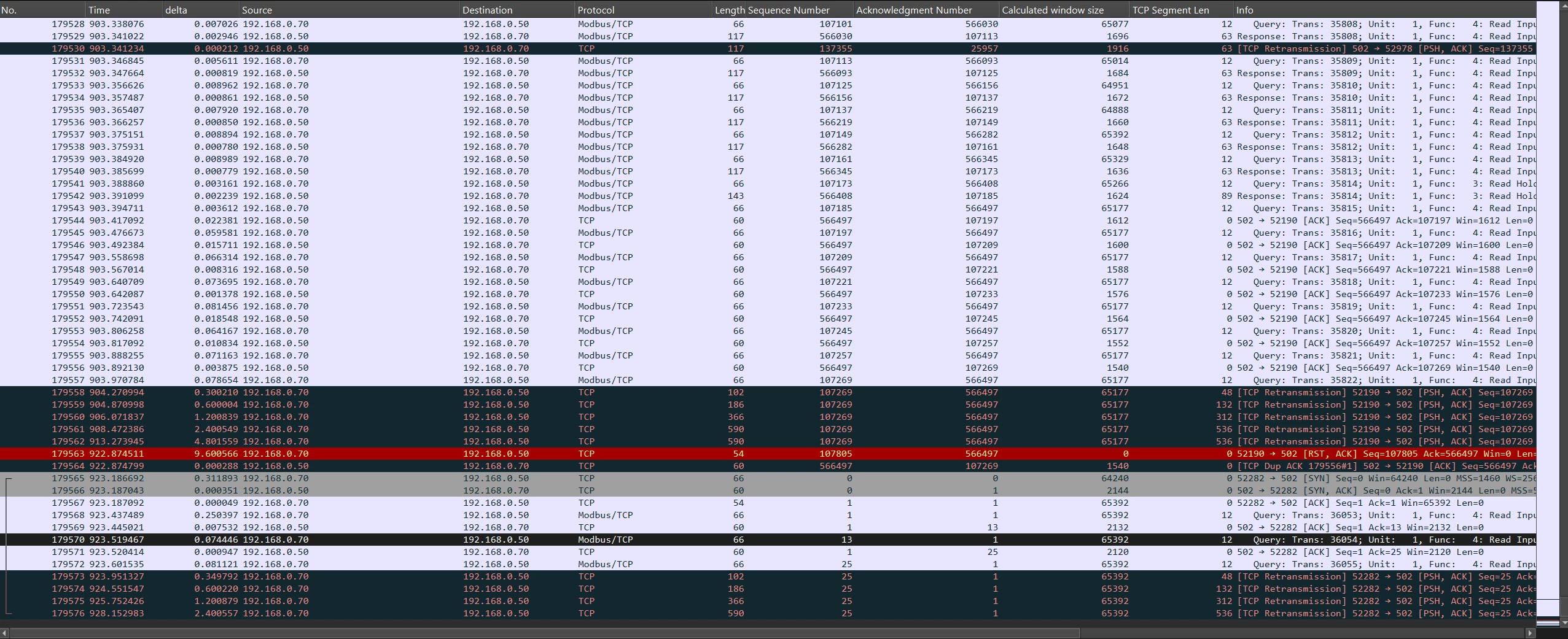

Hello there,
i have some connection/re-connection problems with my opcua server, when i unplug the LAN cable.
Because of prevent memory problems i disable the most Options for the opcua Server. Perhaps in the Future i will try more options out.
But at first the Connection should be stable and when I unplug the LAN cable a re-connection should be possible again.
Perhaps you can help me here.

Jan 22, 2025 4:16 PM UTC
Hi, thank you for your replies.
I need to use LwIP to get open62541 working and it is necessary.
The connection problems come up when I have a open port. For OPCUA for example it is the 4840 - here i cannot reconnect again after cable disconnect, but with modbusTCP i have the problem after the 3 cable disconnect - here i have setup a workaround in my application to disconnect the socket when this happend and with this workaround i dont have the problem anymore.
But with the opcua its very difficult to find a workaround in the same way and i dont want to change to much in the open62541 stack.
When the bug is so well known, perhaps you have some helping links to good description of this bugs and the discussions  @mbarg.1

Oct 10, 2025 11:06 AM UTC
Perhaps this Whireshark section helps to understand:
Pavel A.
Oct 10, 2025 10:46 PM UTC
@JonasReich92 Sorry to know that you suffer from this problem for so long time.
Just a comment while you're waiting for more useful responses. I don't know open62541.
Usually the cable disconnection/reconnection is handled in the following way:
- the program polls the PHY for connection status every so often, as needed. If the PHY provides interrupt to the MCU, this interrupt can be used instead of polling.
- When disconnection (loss of link) is detected, the program must indicate this to the IP stack (LwIP), stop the ETH MAC and drop pending TX packets (or save them if they are precious). For details see ethernetif.c.
- Keep polling
- When the link comes up again: start the MAC with the detected (or hardcoded) speed & duplex, indicate to the IP stack that the link is up. See ethernetif.c again.
The correct detection of link state by the PHY is critical for this procedure. So you must have the correct "driver" for the PHY.   Many older LwIP examples handle the above procedure more or less wrongly (instead of indicating link status they take the interface up/down, etc.).   Some PHYs are smarter than others and can save you from this chore. Especially if you have an embedded [multi-port] switch instead of a simple PHY, the program can just consider the MAC permanently connected at fixed speed.
Recommend to write a simple quick test, without any LwIP, RTOS etc. just poll the PHY and verify that you detect the link changes correctly. Variant: add a simple quick receiver/sender, to verify that packets can be sent/received.
