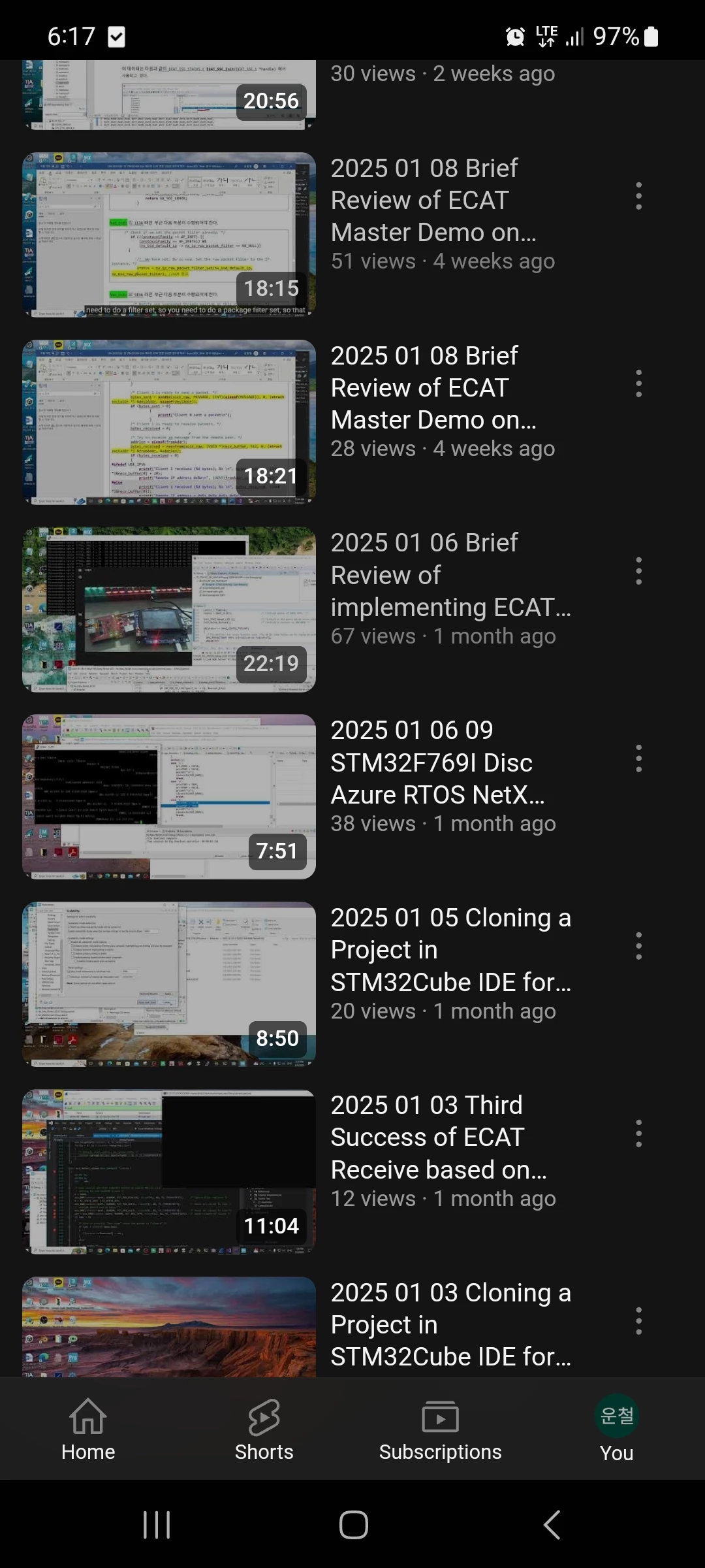

WHam.1
Feb 7, 2025 9:14 AM UTC
Please watch my YouTube for implementation of ECAT master base on stm32F7x and Stm32h7x. Prof. Woonchul Ham
https://www.youtube.com/watch?v=AK2MHlrzZrI
WHam.1
Feb 7, 2025 9:20 AM UTC
