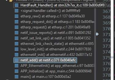

I’m working on a stm32h753 MCU and trying to use LwIP. I followed a lot of topics on that but I’m still not able to make it work.
When I’m using debugger to identify issue, I’m always falling in unaligned access issue.
backtrace in debug

Jun 26, 2026 12:25 UTC
This is a solly question but how to debug those unaligned access ? (I’ve made the modifications on the size)
Pavel A.
Jun 26, 2026 12:37 UTC
The debugger in CubeIDE has special tool for this, Fault analyzer. When your program gets a fault, open it and it will show the available details. If the fault is “precise” (the happy case) , the return PC address displayed there is the instruction that caused the fault. From there you can figure out what the program did, which address it tried to read or write etc.

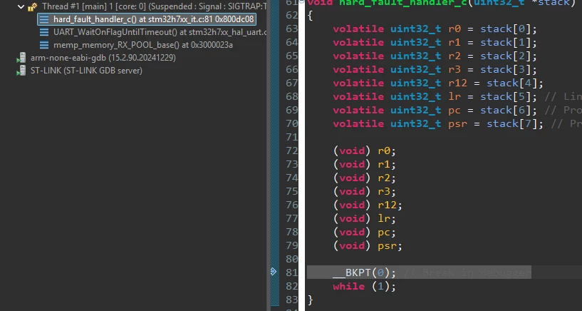

So, I’ve made a bit of investigation, and here is the result :
I’ve added a function to get some information on the hard fault :
What I’m understanding is that the issue is related to the memory rx pool base ?
I’ve also took a look at the PC instruction address which is : 0xce87a7d8 and there is nothing out there.
Is this helping ?
Pavel A.
Jun 29, 2026 20:07 UTC
0xce87a7d8 is not a valid code address for STM32H7. Likely you have a stack corruption. This is hard to debug, unfortunately.
