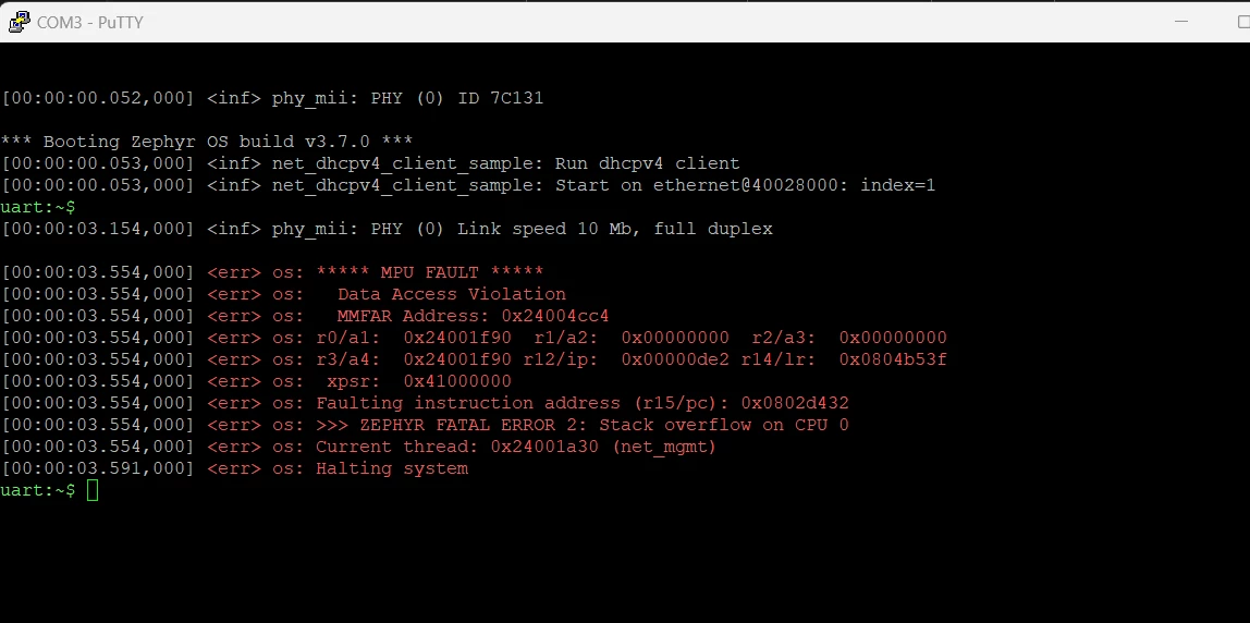

Hi Charles,
Could you please explain what exactly to add to the west.yml file?
I ran a DHCP V4 out of the box on the nucleo h723zg board and ended up with this error.
I have had issues with MPU and fitting in Lwip in the cube ide before.
But this Zephyr is a completely unknown territory for me.
