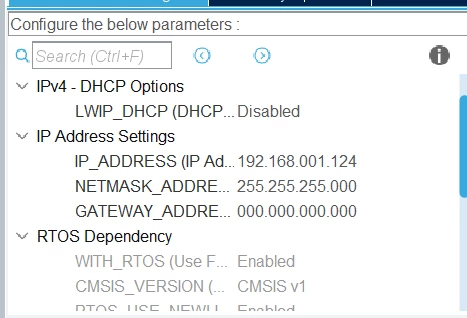

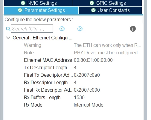

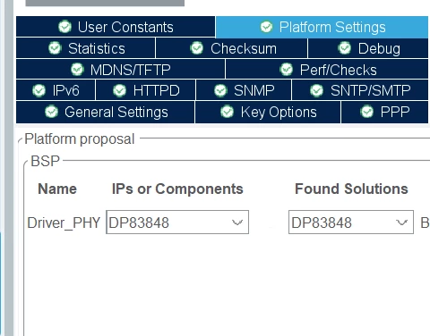

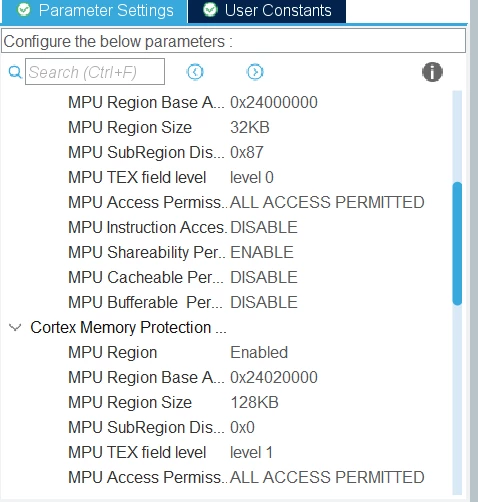

I'm trying to configure my STM32F769NIH6 via the ETH port in "MII full duplex Only" mode and the LwIP library, but I can't make it work as soon as the default task starts everything freezes.
void StartTask_SYS(void const * argument)
 /* init code for LWIP */
 MX_LWIP_Init();
 /* USER CODE BEGIN 5 */
 /* Infinite loop */
 for(;;)
Non capisco dove sto sbagliando, avete dei suggerimenti?

Hello @Daddi,
Thank you for your report. The problem might be due to your IP address configuration. Please try to change the gateway address to be in the same subnet as the IP address.
If your network uses 192.168.1.x, a typical gateway would be 192.168.1.1.
