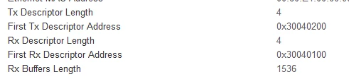

Below, my actual working ETH configuration:

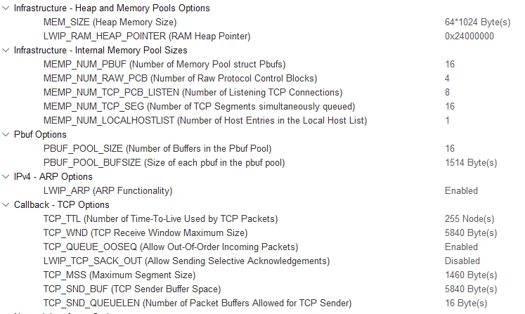

There, my LwIP configuration:
Starting from these, on the ETH side:
  1. What is the descriptors size? (To locate the right memory amount, descriptor size shall be multiplied for the descriptors length, right?)
  2. Rx buffer length is a constant or could be changed? What other parameters will be affected from this?
On the LwIP side (my nightmare):
  1. How several memory-related parameters should be calculated according to others ones?
  2. How much heap shall be allocated?
  3. Is the configuration above is coherent or I'm wasting/missing memory?
the configuration of Ethernet can vary from an STM32 family to another due to the supported modes and features like RMII and MII and the implemented cortex (M4 M7 M33...) as well as the memory that we are using to store the descriptors and buffers causing deferent memory configurations for example the MPU the cachability for M7 based MCUs and security access permission for cortex M33. we try to address each configuration separately in articles as the article you used.
1-What is the descriptors size? (To locate the right memory amount, descriptor size shall be multiplied for the descriptors length, right?)
the descriptor size can be either 96 or 128 bytes depending on the DMA descriptor size we assume in the default configuration it is 128 bytes.
2-Rx buffer length is a constant or could be changed? What other parameters will be affected from this?
the Rx buffer length can be modified, and this will affect the amount of memory allocated in the SRAM for it because we will allocate Rx buffer length * Rx descriptor length.
On the LwIP side (my nightmare) (hope it won't be anymore):
you need to calculate the starting address of the LWIP heap depending on the last address of the RX buffer to properly align all the parameters in the same SRM region to be able to do the proper MPU configuration in one region if needed. this can give you better flexibility in the placement of your allocated memories as you can change the placement to a more rapidly accessed memory for your specific MCU( DTCM ,AXISRAM,SRAM1,SRAM2,external memories using FMC OR OCTOSPI interfaces ...)
Thins depends on your application needs for handling tcp/ip stack and other high-level application protocols (http, ftp ...)
you are placing descriptors and Buffers in SRAM 3 (starting with 0x30040000) which is connected to the Ethernet MAC using 32-bit AHB bus matrix in the D2 domain and placing the LWIP heap in AXISRAM (region starting with 24000000) and you are allocating 64 KB for the LWIP HEAP this can be reduced or added depending on your planned usage if you are not really in need of it you can reduced and place it alongside the buffer and descriptors in the SRAM3 .
