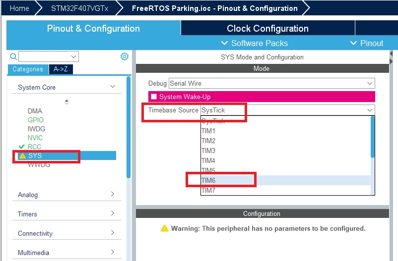

To me when you enable FreeRTOS you need to select another time base for HAL because FreeRTOs is using Systick.
In CubeMx, select another time base source instead of Systick. Example select TIM6:
AzizzAuthor
Dec 26, 2024 11:11 AM UTC
same problem  the code reports that the SVC_Handler, SysTick_Handler, and PendSV_Handler functions are defined twice(when i select TIM6 as time base for HAL).

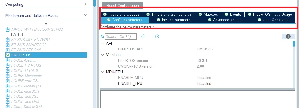

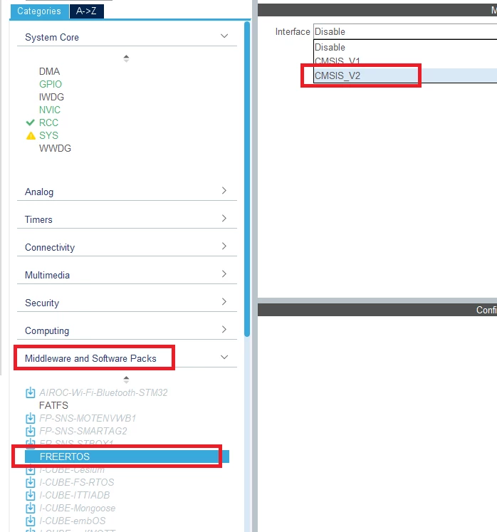

Sorry I didn't understand how you did add FreeRTOS in your project? manually? or over CubeMx?
You need to add FreeRTOS in CubeMx:
Don't add FreeRTOS manually.
You need to configure FreeRTOS, tasks, etc.. in this menu:
And as stated previously, don't forget to set select another time base source instead of Systick.
