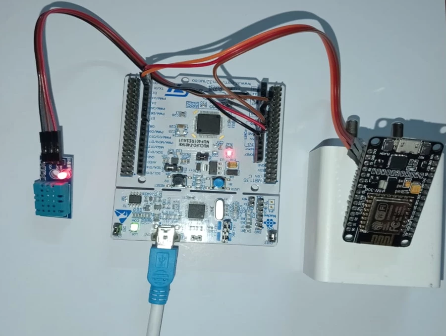

Hiii,
Im trying to interface DHT11 sensor to NucleoF401RE and transfer the data via NodeMCU to Thingspeak
my dht11 code ran sucessfully
Also the NodeMCU code is flashed sucessfully and connected to Wifi

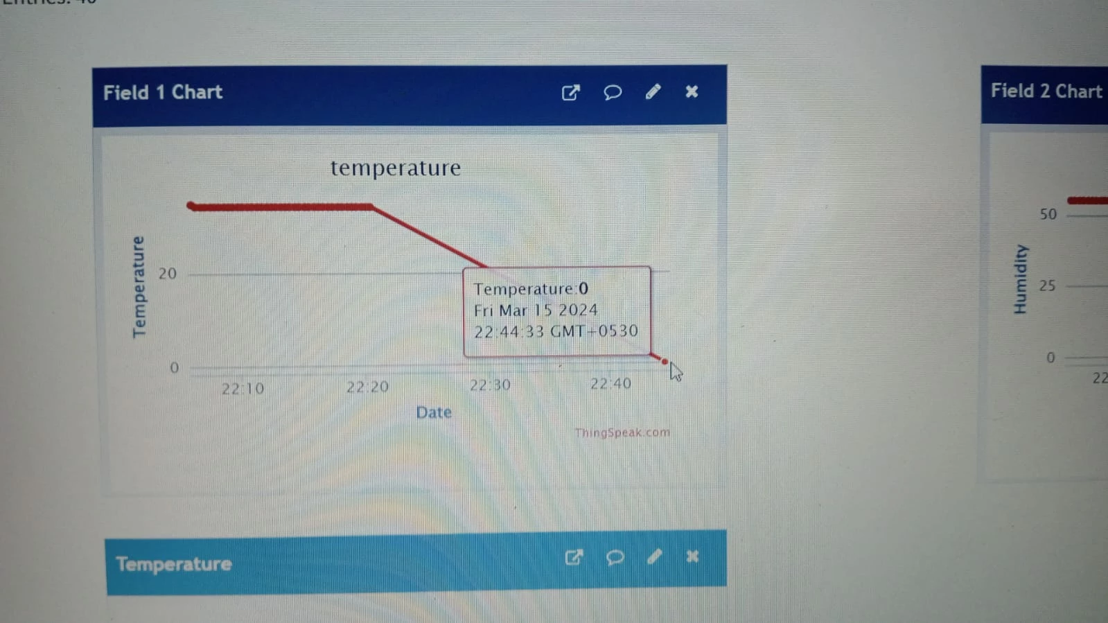

But Im not getting any data in Thingspeak
i got only two datas and the data transfer stopped
How to rectify this issue????

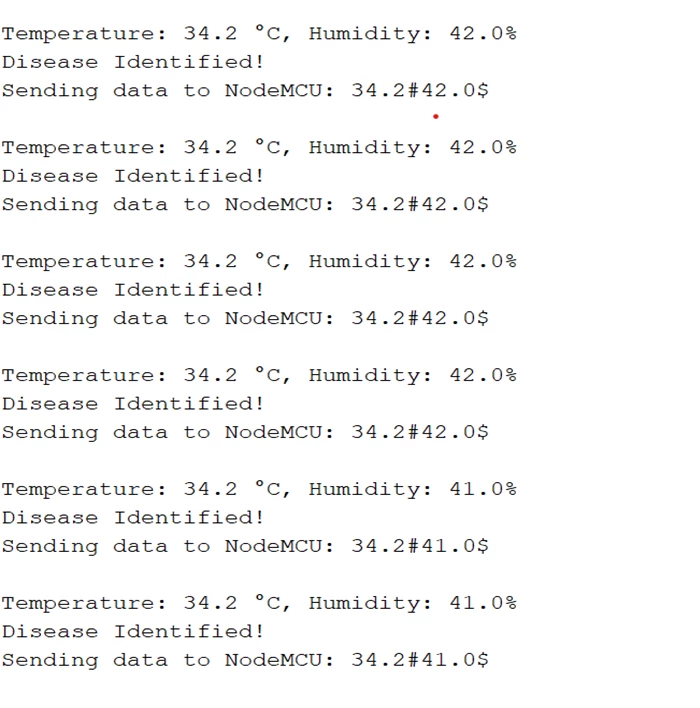

LG.5
LG.5Author
Mar 16, 2024 4:49 AM UTC
Hii!
If i connect the DHT11 directly to NodeMCU its working fine and im getting values in Thingspeak
But if i try to send the data from NUCLEOF401RE to NodeMCU then null value is thrown in Thingspeak

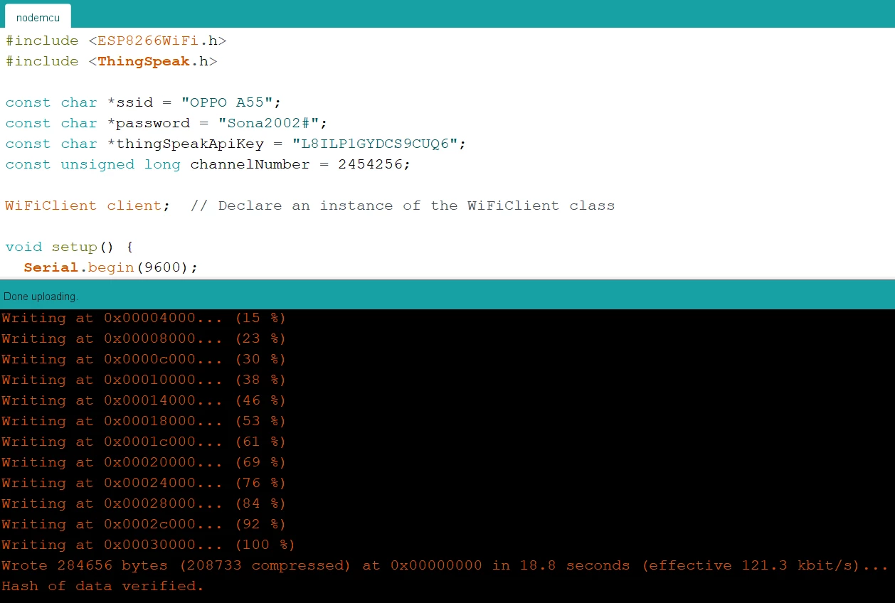

#include <ESP8266WiFi.h>
#include <ThingSpeak.h>
const char *ssid = "OPPO A55";
const char *password = "Sona2002#";
const char *thingSpeakApiKey = "L2UFGKXGO98IUE2S";
const unsigned long channelNumber = 2472082;
WiFiClient client; // Declare an instance of the WiFiClient class
void setup() {
Serial.begin(9600);
delay(10);
// Connect to Wi-Fi
WiFi.begin(ssid, password);
while (WiFi.status() != WL_CONNECTED) {
delay(1000);
Serial.println("Connecting to WiFi...");
Serial.println("Connected to WiFi");
// Use the WiFiClient instance to initialize ThingSpeak
ThingSpeak.begin(client);
void loop() {
if (Serial.available() > 0) {
String data = Serial.readStringUntil('\n');
Serial.println("Received data from STM32: " + data);
// Split data into temperature and humidity
float temperature = data.substring(0, data.indexOf('#')).toFloat();
float humidity = data.substring(data.indexOf('#') + 1, data.indexOf('$')).toFloat();
// Update ThingSpeak channel with sensor readings
updateThingSpeak(temperature, humidity);
void updateThingSpeak(float temperature, float humidity) {
ThingSpeak.setField(1, temperature);
ThingSpeak.setField(2, humidity);
int status = ThingSpeak.writeFields(channelNumber, thingSpeakApiKey);
if (status == 200) {
Serial.println("ThingSpeak update successful");
} else {
Serial.println("Failed to update ThingSpeak");
delay(1000); // ThingSpeak update interval (in milliseconds)
This is my NodeMCU code
Please help to rectify this issue
