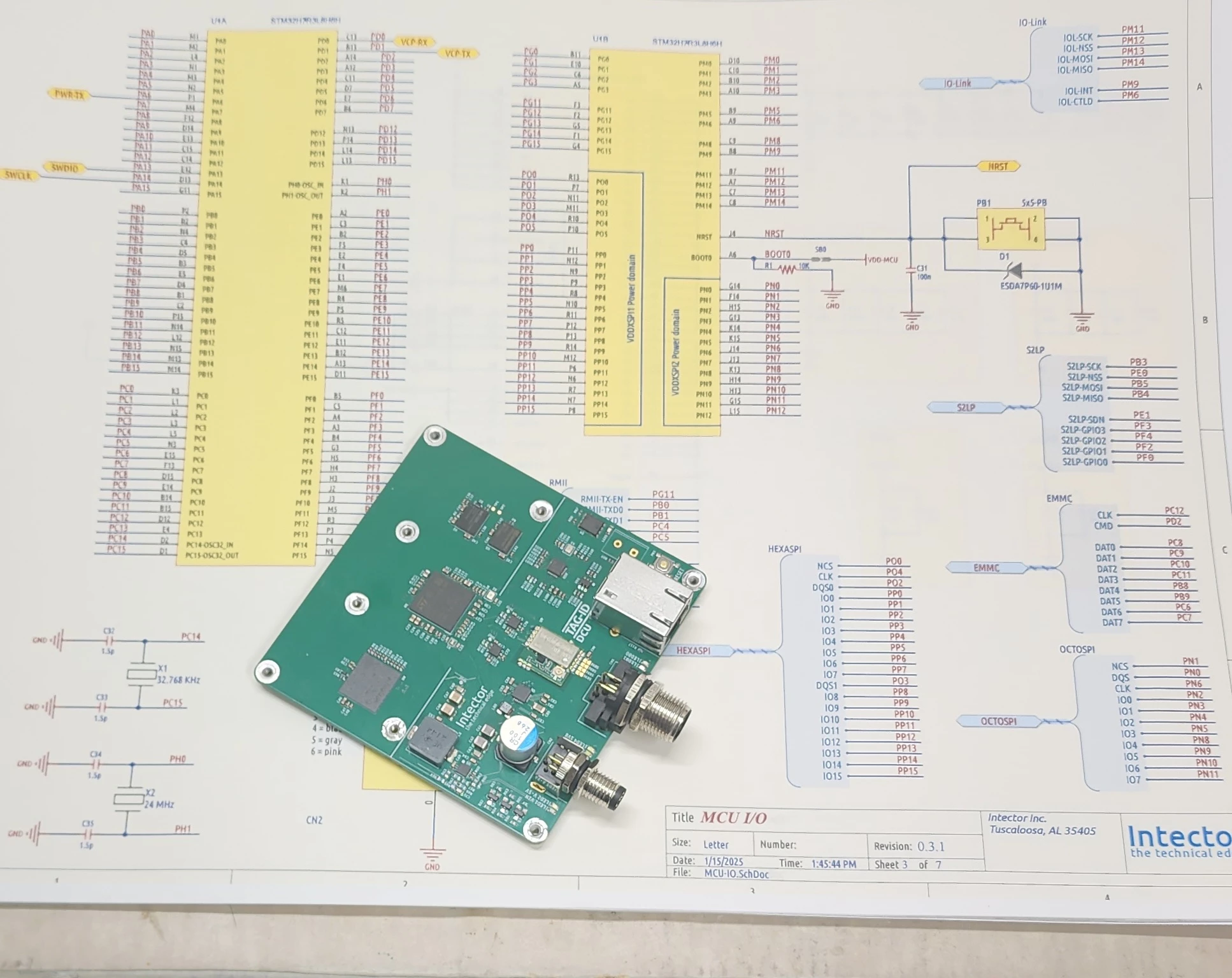

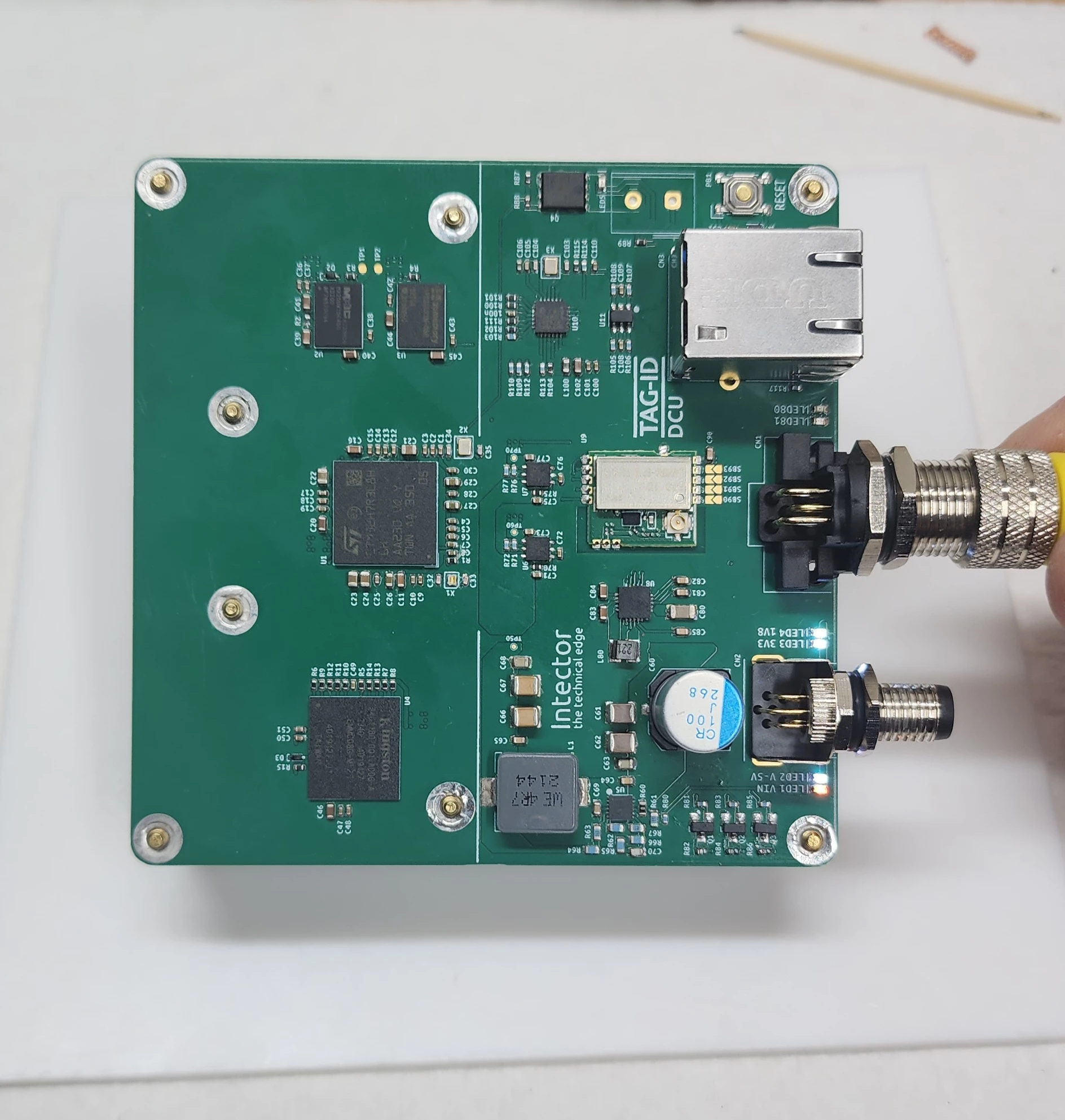

Do you know a description of using an APS256XXN-OBRx with an STM32H7RS series MCU?
I made a board for my project, which is based on an STM32H7R3L8H6H MCU, an APS256XXN-OBR-BG 256MBit PSRAM on HEXASPI, an MX25UW25645GXDI00-T 256MBit flash on OCTOSPI, and an EMMC08G-MV28-01J10 SDMMC, among other peripherals.
Here are some pictures of it:
Thanks to Mohamed_Aziz_REZGUI's post, I was able to optimize the MX25UW25645GXDI00-T on the OCTOSPI.
The APS256XXN-OBR-BG on the HEXASPI is working, but it's probably not optimal. The example code for the STM32H7S78-DK that I found in the firmware package "STM32Cube_FW_H7RS_V1.1.0" contains several bugs and flaws. I spent countless hours searching the Internet for something useful, but unfortunately, I couldn't find anything.
