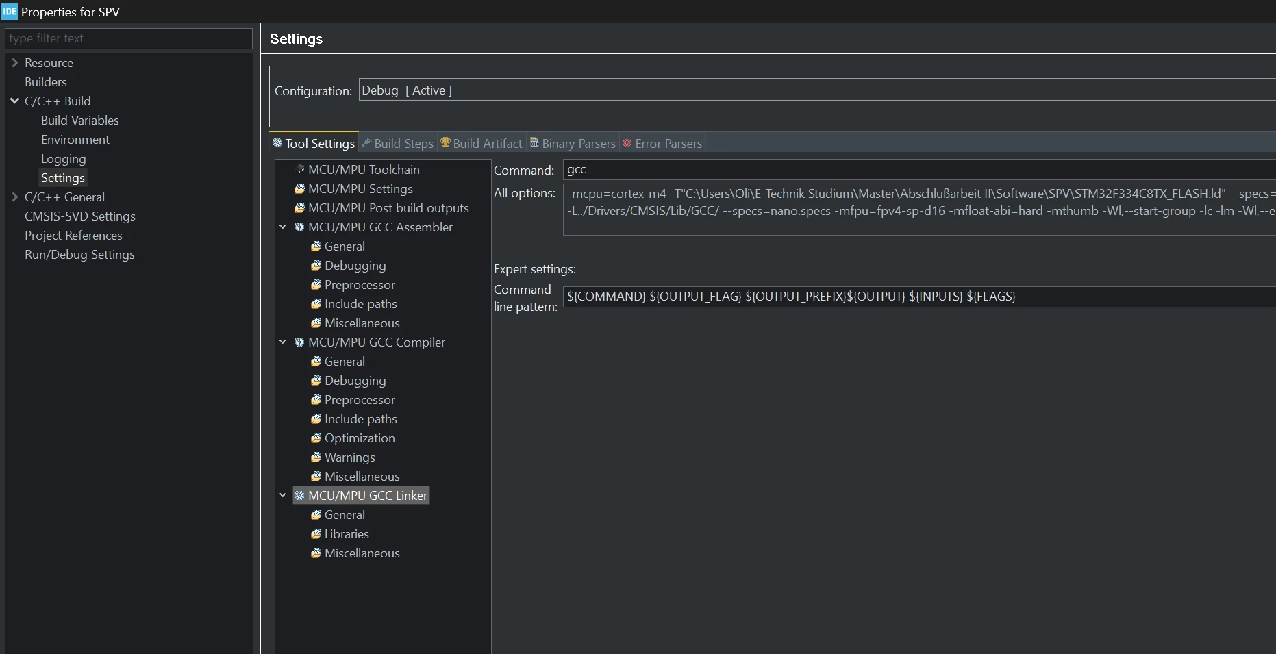

It would likely be a mismatch in -cpu, -arch or --fpu command line options, where by it thinks its build for a cm3 vs cm4, or a soft fp
The Linker can also complain if objects or libraries mismatch.

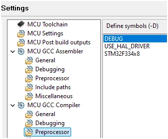

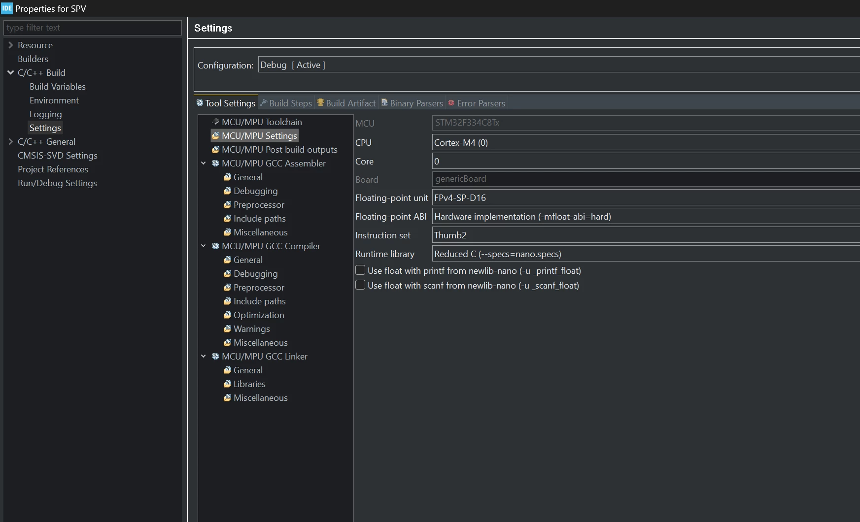

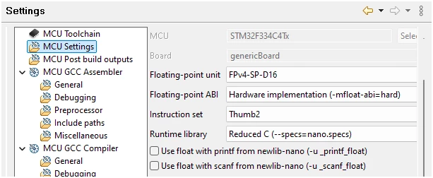

I'm quietly sure that my F334 has a fpu. Even though it was a long time ago, but I used it already, and in the current project I'm working with arm_math.h and it's float32_t types, and it built fine yesterday and today morning.
The error message in my first post contains a link to a file "Drivers/CMSIS/include/core_cm4.h". I think, as the F334 bases on a M4 core, this should be fine (shouldn't it?).
The compiler settings does also not looking wrong to me, but to be hornest I have no idea what really would right or wrong, so I better attach a screenshot of them.

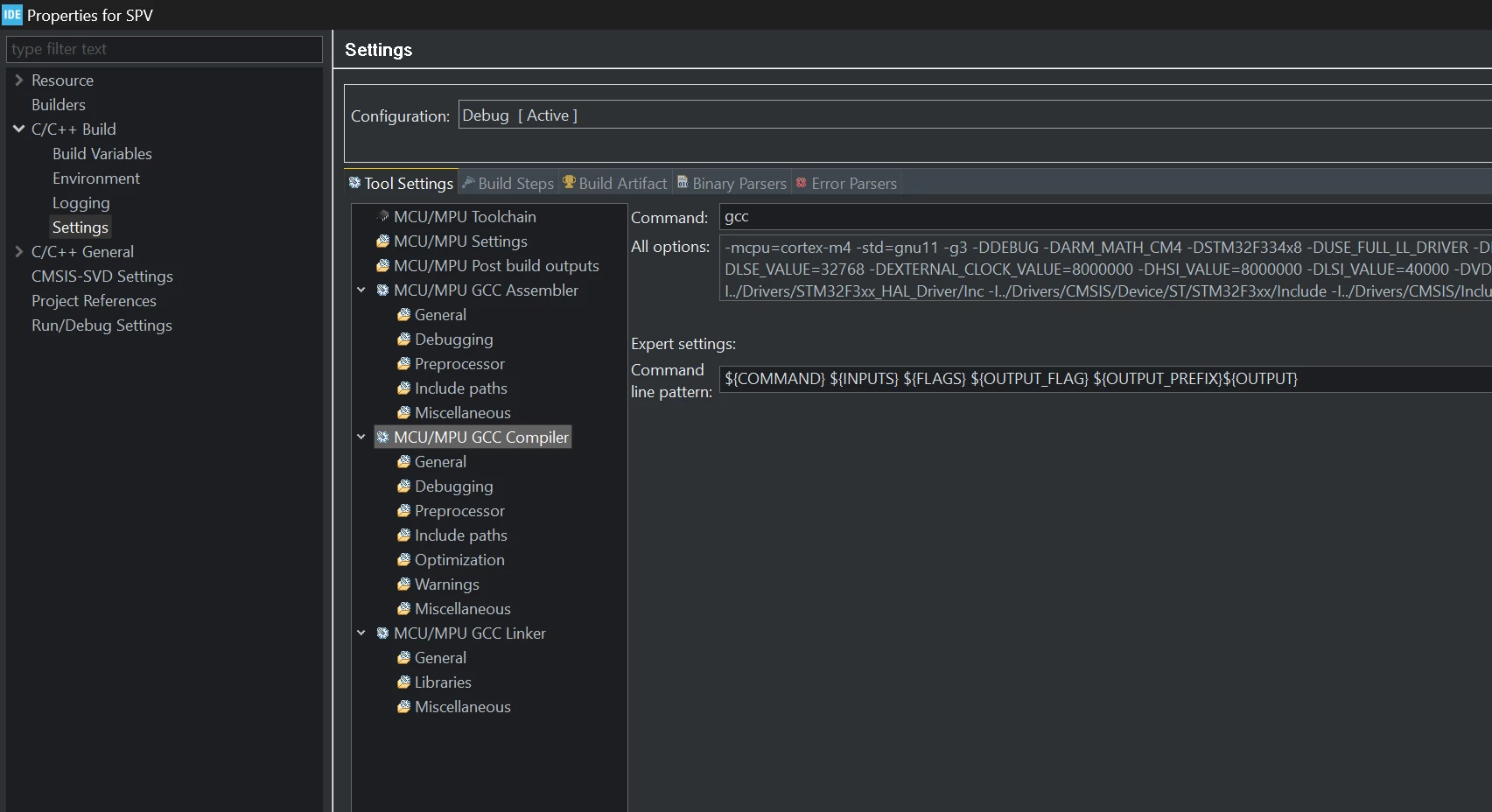

Show the command line used to compile and the complete output of compilation (copypaste text, don't screenshot).
White_FoxAuthor
Sep 12, 2024 2:04 PM UTC
Here is the whole console output after a build run:
15:57:26 **** Incremental Build of configuration Debug for project SPV ****
make -j32 all
arm-none-eabi-gcc "../Core/Src/trs.c" -mcpu=cortex-m4 -std=gnu11 -g3 -DDEBUG -DARM_MATH_CM4 -DSTM32F334x8 -DUSE_FULL_LL_DRIVER -DHSE_VALUE=8000000 -DHSE_STARTUP_TIMEOUT=100 -DLSE_STARTUP_TIMEOUT=5000 -DLSE_VALUE=32768 -DEXTERNAL_CLOCK_VALUE=8000000 -DHSI_VALUE=8000000 -DLSI_VALUE=40000 -DVDD_VALUE=3300 -DPREFETCH_ENABLE=1 -c -I../Core/Inc -I../Drivers/CMSIS/DSP/Include -I../Drivers/STM32F3xx_HAL_Driver/Inc -I../Drivers/CMSIS/Device/ST/STM32F3xx/Include -I../Drivers/CMSIS/Include -O0 -ffunction-sections -fdata-sections -Wall -fstack-usage -fcyclomatic-complexity -MMD -MP -MF"Core/Src/trs.d" -MT"Core/Src/trs.o" --specs=nano.specs -mfpu=fpv4-sp-d16 -mfloat-abi=hard -mthumb -o "Core/Src/trs.o"
In file included from ../Drivers/CMSIS/DSP/Include/arm_math.h:322,
from ../Core/Inc/trs.h:12,
from ../Core/Src/trs.c:10:
../Drivers/CMSIS/Include/core_cm4.h:105:8: error: #error "Compiler generates FPU instructions for a device without an FPU (check __FPU_PRESENT)"
105 | #error "Compiler generates FPU instructions for a device without an FPU (check __FPU_PRESENT)"
make: *** [Core/Src/subdir.mk:49: Core/Src/trs.o] Error 1
"make -j32 all" terminated with exit code 2. Build might be incomplete.
15:57:26 Build Failed. 2 errors, 0 warnings. (took 280ms)

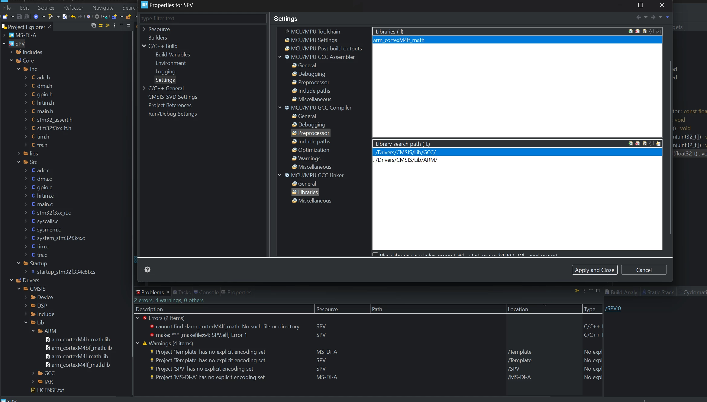

It is getting more interesting now. I did as waclawek.jan told me, and I get a new error.
I do not have a file stm32f3xx.h in my Core/Inc directory, but a file stm32f3xx_it.h. I tried both, and get the same error in both cases:
Description Resource Path Location Type
cannot find -larm_cortexM4lf_math: No such file or directory SPV C/C++ Problem
But I remember that I worked at this file before the fpu problem occured first time, and including the arm_math.h file was related of one of the last actions I did.
To the new error message: I included the arm_math.h several times before (and used it!) without any problem. It is a miracle to me why it provokes this trouble now. I also have the file in my project folder, but did not added its path to the linker. But even I do so, the error message above remains.
