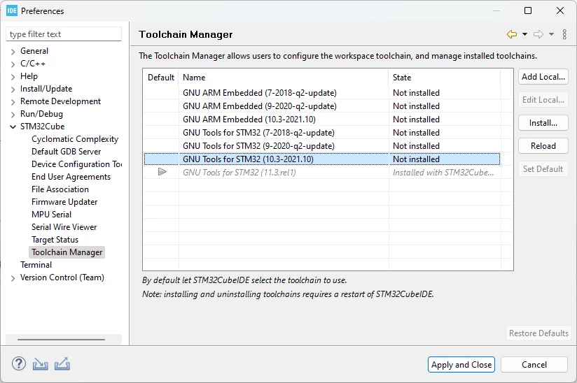

    MSatt.4
    Aug 8, 2023 1:23 PM UTC
    Can also just install the previous toolchain easily enough...
    Marcelo Jimenez
    Aug 16, 2023 10:21 PM UTC
    Installing GNU Tools for STM32 version 10.3 worked perfectly for me. Printf stopped calling the error handler. Thanks!
