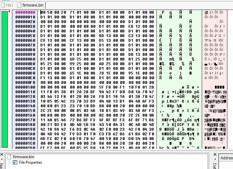

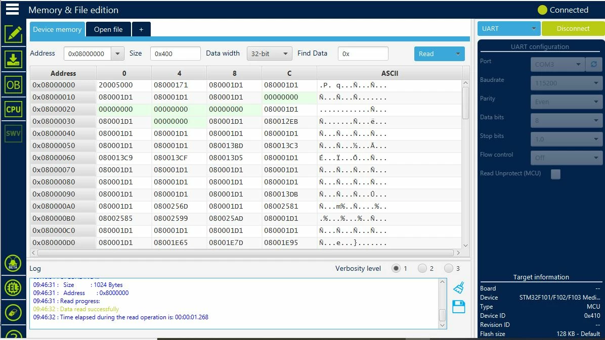

0693W00000FDzveQAD.jpgI am not sure, but I can share some info about the hex file, hex file a text(ASCII) file that have information about binary data. It can and is used for programming(your mcu e.g). You can should take a look at the generated .bin file, in my opinion it is more clear. You just need to know where the user code memory is, in the mcu.
As .bin file is a binary file, simple text editor would not be a good option for viewing, use a hex viewer softer(I use FlexHex).
See the attached file, it is a bliki code for the stm32f103(blue pill), note that the file start from address 0x00000000, this data is to be programmed at the address 0x08000000 in the blue pill. Also see the attached stm32cubeProgrammer view of the code when inside the mcu. The stm32cubeprorammer is shows the address little differently. The STVP would have made it clear but currently I don't have a ST-Link at the movement.
