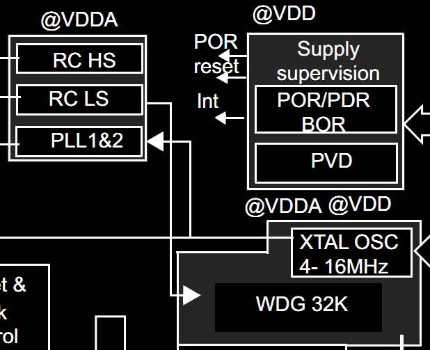

how can I read back the status of IWDG, ensuring that's it's running, as a safety measure?
As I know direct counter value is not accessible, that would be ideal to see that it's not stuck.
How to detect if LSI (thus IWDG) stopped running?
As I found HAL/registers are mostly write only, not intended to be read back.

Depends what level of paranoia you want to design your system for, or what requirements you're trying to meet. Ensuring LSI is on/ready and checking for IWDG_RSTF once seems sufficient here.

When you boot up, after starting the IWDG, look at reset flags to see if IWDG caused the reset (IWDG_RSTF). If not, then wait until it does.
Note that IWDG has its own clock independent of the common "LSI" clock in the chip. Not sure if this is true or not. The RM suggests it does. CubeMX suggests it doesn't.
Edit: You can update the PR and RLR registers and see that RVU/PVU bits get cleared as a spot-check to see if the IWDG clock is active.

Good idea on the update bit, although in order to write I have to unlock the WDT which I think is only possible after it's enabled.
So worst case I could fully reconfigure the WDT when it's time to feed it. But after writing RLR checking for update bits costs nothing, hopefully they don't soon.
It would be great if ST provided more status info, or best the read only counter value to see if it gets stuck.
Or maybe I could turn the LSI into a second WDT, since it's already running.

RCC_CSR.LSIRDY should indicate that LSI is on. In some STM32, LSI is brought in as some timer's channel (e.g. TIM5_CH4 in 'F407), so there its frequency can be observed.
There's probably no direct indication of IWDG running.
Is this attempt to fulfill some regulatory requirement ("functional safety")?

Yes it's for functional safety.
Looks like it's fed by common LSI, At least I can check that it's value is not stuck.
Big enough problem that the LSI has +-50% tolerance.
This is consequence of ST poorly handling "integration" (slapping on) of docs of various modules into the whole. While the IWDG chapter, written without the whole in mind for the IWDG specifically, talks about "dedicated low power oscillator"; the RCC chapter has a dedicated "Watchdog clock" subchapter clearly stating that IWDG uses LSI (at least it does in RM0090; I am not bothered to look up the specific 'F401 RM).
