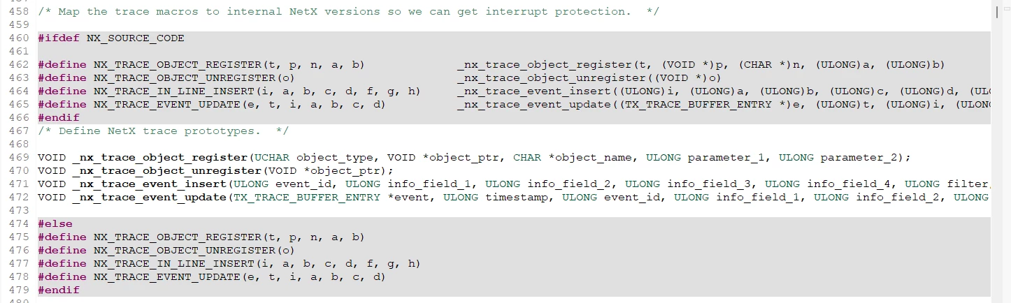

I am attempting to use TraceX in my NetXDuo application. But when I enable TraceX in the Software Packs of CubeIDE (TX_ENABLE_EVENT_TRACE) I get compiler errors in all of the calls to save a tracex event. The macros that defines the calls to tracex services appear in nx_api.h, but are not defined, and hence the _nx_trace_event_ service is never defined.
I saw a discussion of this same issue over in the Renesis community where a workaound fixed the compiler issue.
https://community.renesas.com/mcu-mpu/embedded-system-platform/f/forum/10314/undefined-reference-to-nx_trace_in_line_insert-when-arp-probe
But t his workaround did not fix the STM code.

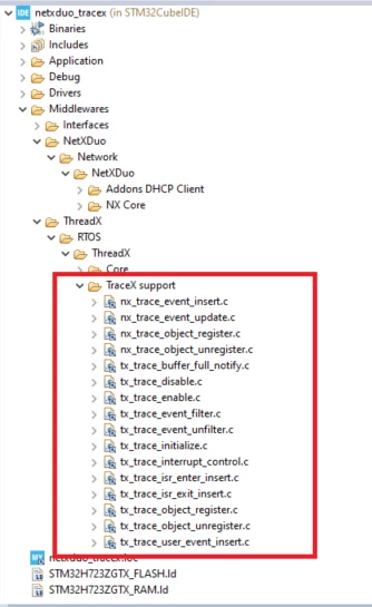

By the way can you check that the NetXDuo trace files (nx_trace_*) are added to your project when enabling TraceX support

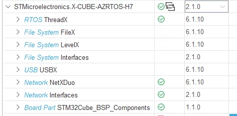

X-CUBE-AZRTOS Versions
0693W00000YAifxQAD.pngMy program is based off of the Nx_TCP_Echo_Server example. I have added additional user code which forwards commands received from a TCP client to USART2. The response received from the USART is then forwarded back to the client. This all works as expected, except that occasionally the network connection is dropped. I need to use TraceX to debug this issue.
I don't see any nx_trace_ code inserted into main.c, app_nextduo.c, or app_azure_rtos.c. I manually inserted the following into app_threadx.c per the training video.

Can you try with X-CUBE-AZRTOS-H7 V3.0.0
I attached an ioc file created with STM32CubeMX 6.7.0 and X-CUBE-AZRTOS-H7 V3.0.0 that helps you to enable the TraceX support for NetXDuo :

I did install V3.0 X-CUBE-AZRTOS-H7 and now see the TraceX support files as shown in your screenshot.

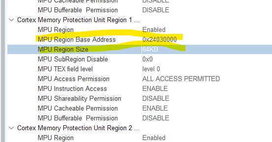

I made the memory allocation modifications that you recommended. But I still get a Hard Fault when the byte_pool allocation attempts to allocate greater that 32kbytes.
Here is what I modified.
  • I modified the STM32H723ZGTX_FLASH.ld.file per your recommendations above.
  • I modified the .ioc GUI as below (code gets modified during code-regeneration if modified directly in main.c)
  • When attempting to execute tx_byte_allocate as the byte_pool exceeds 32kbyte, I get a hard fault at this statement.

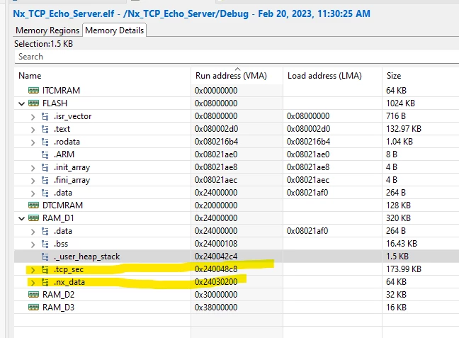

  • The byte_pool->tx_byte_pool_search value is 0x24037b88 which is just below 32kbytes. During this allocation is when the hard fault is thrown.
  • And here is the build analyzer showing the allocations. Is the order correct?
0693W00000aHF3SQAW.pngCould there be some other setting that limits the allocated memory to 32kbytes?
