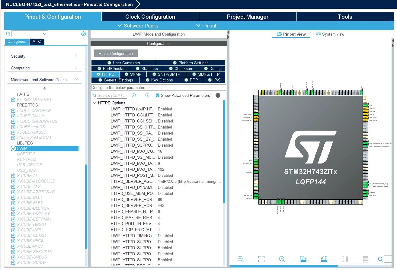

Hi, I'm playing around with lwIP on my Nucleo-H743ZI and I was able to make ping work, udp/tcp echo and snmp too. But when I enable HTTPd the project doesn't wont do compile I just get a lot of undefined references, I tried to make a new project and same thing happened. This are the compiler error messages that I get:
Core/Src/main.c:113: undefined reference to `httpd_init'
LWIP/App/lwip.o: in function `MX_LWIP_Init':
LWIP/App/lwip.c:80: undefined reference to `lwip_init'
LWIP/App/lwip.c:88: undefined reference to `netif_add'
LWIP/App/lwip.c:91: undefined reference to `netif_set_default'
LWIP/App/lwip.c:96: undefined reference to `netif_set_up'
LWIP/App/lwip.c:101: undefined reference to `netif_set_down'
LWIP/App/lwip.c:105: undefined reference to `netif_set_link_callback'
LWIP/App/lwip.c:112: undefined reference to `ethernet_input'
LWIP/App/lwip.c:161: undefined reference to `sys_check_timeouts'
LWIP/Target/ethernetif.c:202: undefined reference to `memp_init_pool'
LWIP/Target/ethernetif.c:348: undefined reference to `pbuf_free'
LWIP/Target/ethernetif.c:431: undefined reference to `etharp_output'
LWIP/Target/ethernetif.c:441: undefined reference to `memp_free_pool'
LWIP/Target/ethernetif.c:660: undefined reference to `netif_set_down'
LWIP/Target/ethernetif.c:661: undefined reference to `netif_set_link_down'
LWIP/Target/ethernetif.c:699: undefined reference to `netif_set_up'
LWIP/Target/ethernetif.c:700: undefined reference to `netif_set_link_up'
LWIP/Target/ethernetif.c:709: undefined reference to `memp_malloc_pool'
LWIP/Target/ethernetif.c:718: undefined reference to `pbuf_alloced_custom'
I did include httpd.h in main and I try manually including other libs but it didn't help. When disable http it compiles normally.
I'm new to this so any advice will be helpful.
Thanks in advance
Alex

HI everybody, have exactly the same problem on STM32CubeIDE v1.13.1 and MCU package for STMH7 v 1.11.1. I develop for nucleo-h743ZI board. Example LwIP_HTTP_Server_Raw compile and works with mods of pin connection for ethernet phy
I expect one of us have solution :)

when I enable HTTPd
What exactly does this mean? Where do you enable it?
Visitor II
August 24, 2023
look at joined screen capture to see  the meaning of "httpd activation" in the tab with the same name

I compile the joined example with STM32CubeIDE V 1.13.1 and STM32CubeH7 Firmware Package V1.11.0 / 04-Nov-2022.
With httpd disabled in lwip settings (in ioc window) all compile and televerse correctly, ping to the address fixed (192.168.1.250) is OK.
When httpd enabled -> compilation error like Abeslic described in his post

Try manually to unexclud lwIP lib from the build.

I had exactly the same problem, everything worked great until i enabled HTTPD in the project. This is because the middlewares folder is not included or something. Go to Properties ->C/C++ General -> Paths and Symbols -> Source Location. Before you enabled the HTTPD feature it had 4 folders, after enabling it it has 3 folders. The Middlewares folder is gone, why? I don't know. Just add the Middlewares folder and it works again.

The issue is still present in the latest version 6.11.1 of CubeMX. After enabling the "HTTPD" feature in the LwIP middleware, it is necessary to add the Middlewares directory to the source location.
