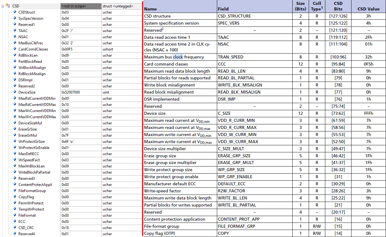

eMMC on STM32H743 always Disk Error
  • November 15, 2019
  • 3 replies
  • 2379 views
Like old topic says : https://community.st.com/s/question/0D50X0000BbNEpXSQW/fatfs-emmc-always-frdiskerror?t=1573783271738
I`m trying to build project for STM32H743 with STM32CubeMX, and use eMMC for my storage space.
eMMC : Micron 4GB
Manager File : FATFS
This is the (Left)CSD Register it retured & (Right)the Micron datasheet
And I have no ideal about
MaxRdCurrentVddMin,
MaxRdCurrentVddMax,
MaxWrCurrentVddMin,
MaxWrCurrentVddMax, are all zero,but the true value is not.
Can anyone help?
I`ll really appreciate.

Hi, were you able to solve this? I am getting the same error when I try to use an SD card with STM32H7

Hi @schumilop​
Getting the same error doesn't mean the same root cause.
since you are using the SD card, you may check one of the reference apps provided within the CubeFW package.
for example this one:
https://github.com/STMicroelectronics/STM32CubeH7/tree/master/Projects/STM32H743I-EVAL/Applications/FatFs/FatFs_uSD_DMA_Standalone
Haithem Rahmani
July 15, 2021
Hi @Charlie CHEN​
Could you try to use the Polling API instead of the DMA one to discard any potential issue related to cachee maintenance?
regards
