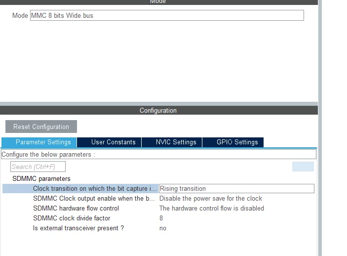

I have an eMMC chip connected to a STM32U5G9
The .IOC file is all standard:

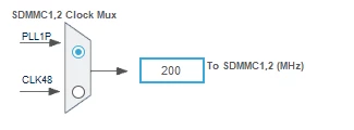

with the clock config as follows:

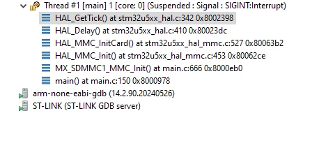

However, when I start a debugging session I get stuck in the init function like so:
It looks almost like the sysTick is not being updated at this point so the whole init just stalls.
If I comment-out the MX_SDMMC1_MMC_Init() the whole system runs as intended (having a touchGFX application that boots right after the inits)

Look at the code where it's paused and why it's stuck there, in HAL_MMC_InitCard. The issue is probably not HAL_Delay directly but rather *why* it's waiting. The generated code probably expects an MMC card as opposed to an eMMC chip. There are subtle differences.

Are you using the Systick timer as HAL time base?

Thanks for your reply - I am using TIM1 as the timebase.
I have created a separate project with just the eMMC and have been running tests on that.
I have removed TouchGFX and FreeRTOS and got the init function to work with first 1-bit MMC and later 8-bit wide MMC. adjusting the clock division to 12 helped.
However, the full system is still not working - Should I change to ThreadX for better support?

You can add FreeRTOS to your test project and check again. The issue may be related to interrupt priorities.
