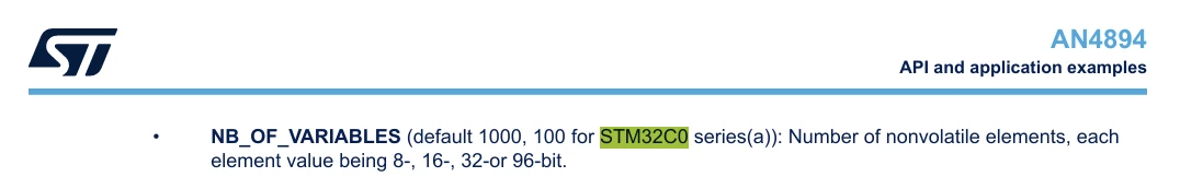

I am using the EEPROM emulation (X-CUBE-EEPROM) on a STM32C0.
The default setting for number of variables is 100 : In eeprom_emul_conf.h :
#define NB_OF_VARIABLES         100U  /*!< Number of variables to handle in eeprom */
If I understand this emulation correctly, it uses a number of 2K flash pages (minimum 2 for alternating...).
Also, each (32bit) variable is stored as 8 bytes : 16bit virtual address, 32bit data, 16bit CRC.
I understood there is also some header overhead of 32 bytes per 2K page.
So the number of variables fitting in a single page is (2048 - 32) / 8 = 252
So my question is then : why is the default value set to 100 io. 252 ???

Yes, it's the Appliction Note that mentions a default of 100 for STM32C0.
I like to understand why it's not default 252, because I think this allows more variables while not consuming any more flash.

From the application note, I understand that 252 variables is the maximum for 2+2K flash, but also that it's better to not fill it up completely. If you fill it up completely with 252 variables, every change on any of the variables, requires the whole page to be rewritten in the the other flash page, so consuming a erase/write cycle per single change.
If you store eg 126 variables, you can change all of them before the page is full and needs a rewrite.
I've also found that the NM_OF_VARIABLES setting, controls a loop in the eeprom emulation library, but it's not yet 100% clear to me what is the effect.

Yes it’s correct, if you use the full amount of data that can be contain in a single page and that you are writing each of these, you’re falling in this case you’re describing. That is also why there is a guard pages mechanism, to prevent this full page transfer each time a variable is updated, allowing to have extra pages without needing to change your “true” variables number.
I hope this will help you,
