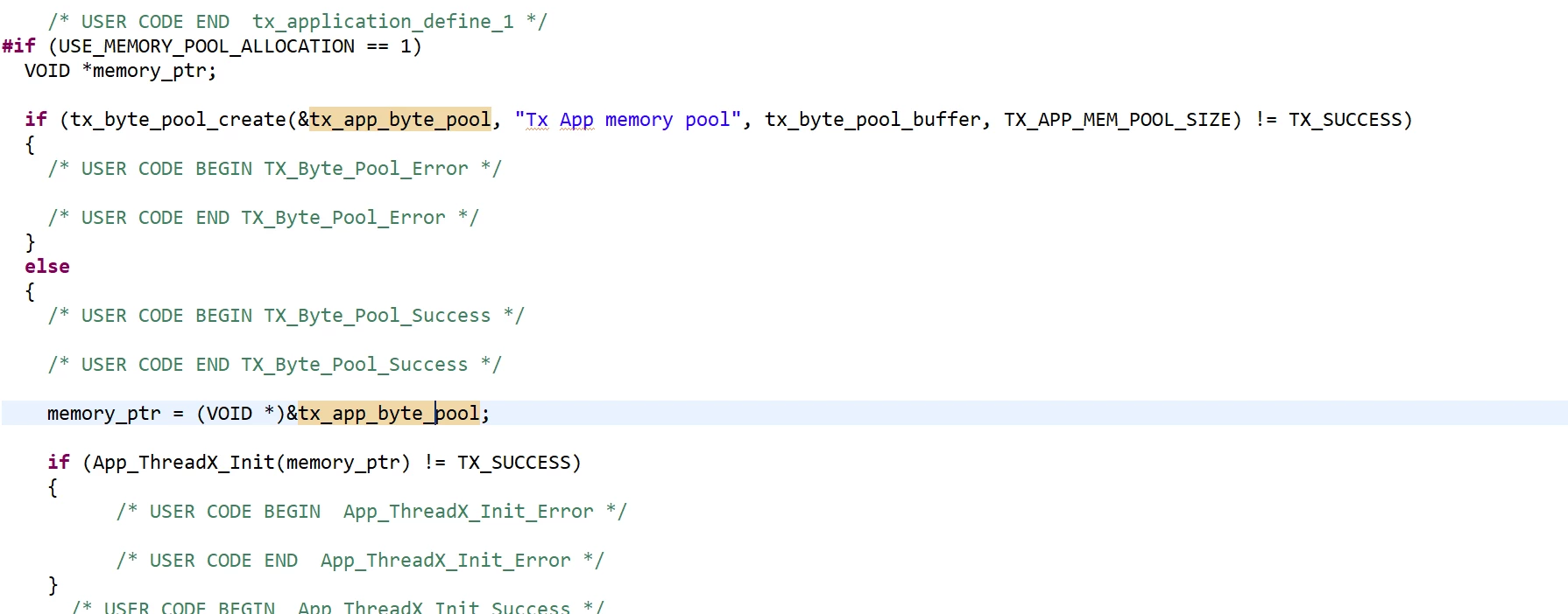

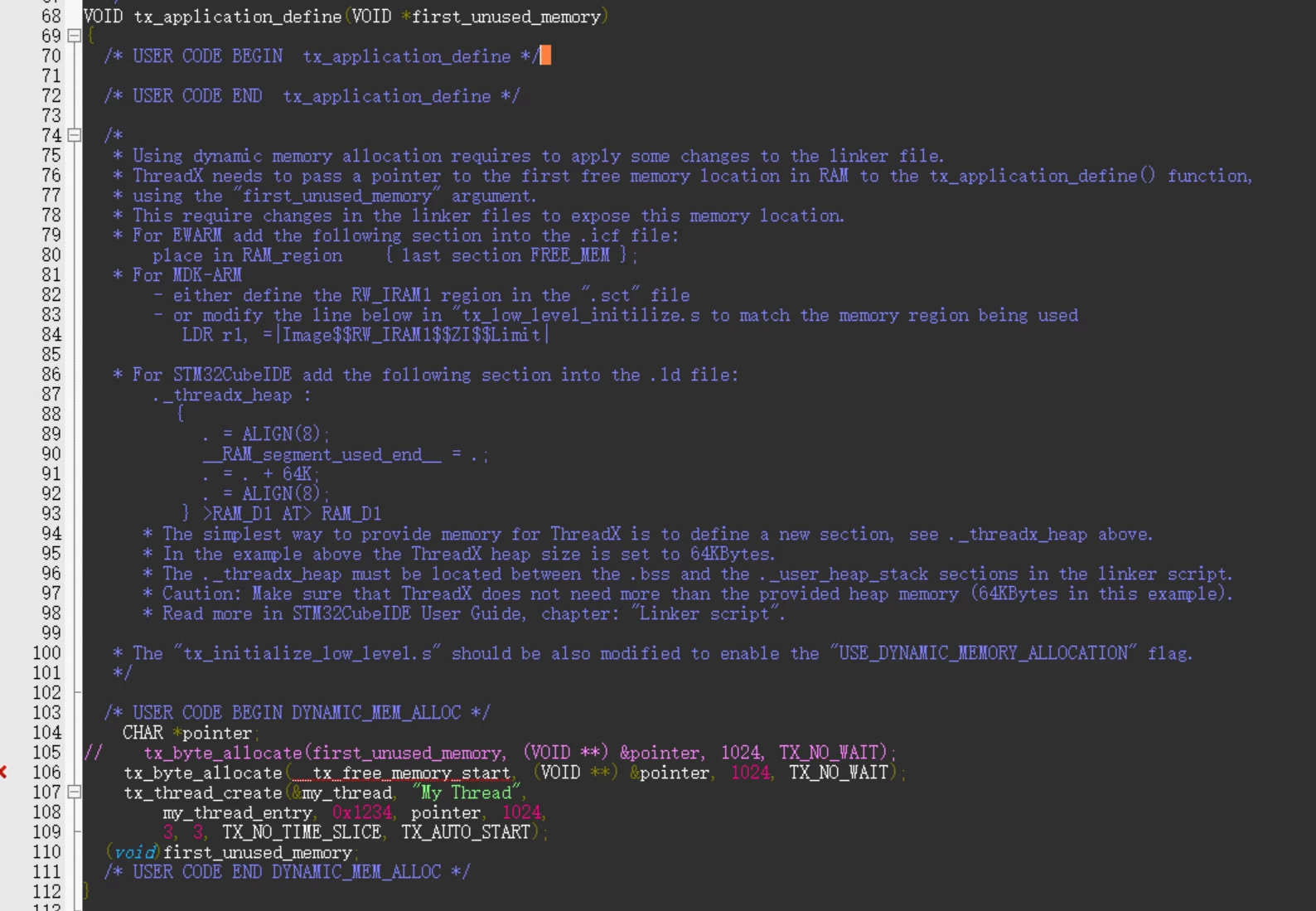

if I choose dynamic memory allocation, how should I allocate for it?

Hello @Szhen.1​ ,
Take a look at this document: OSRTOS | Azure RTOS
This might help you.
